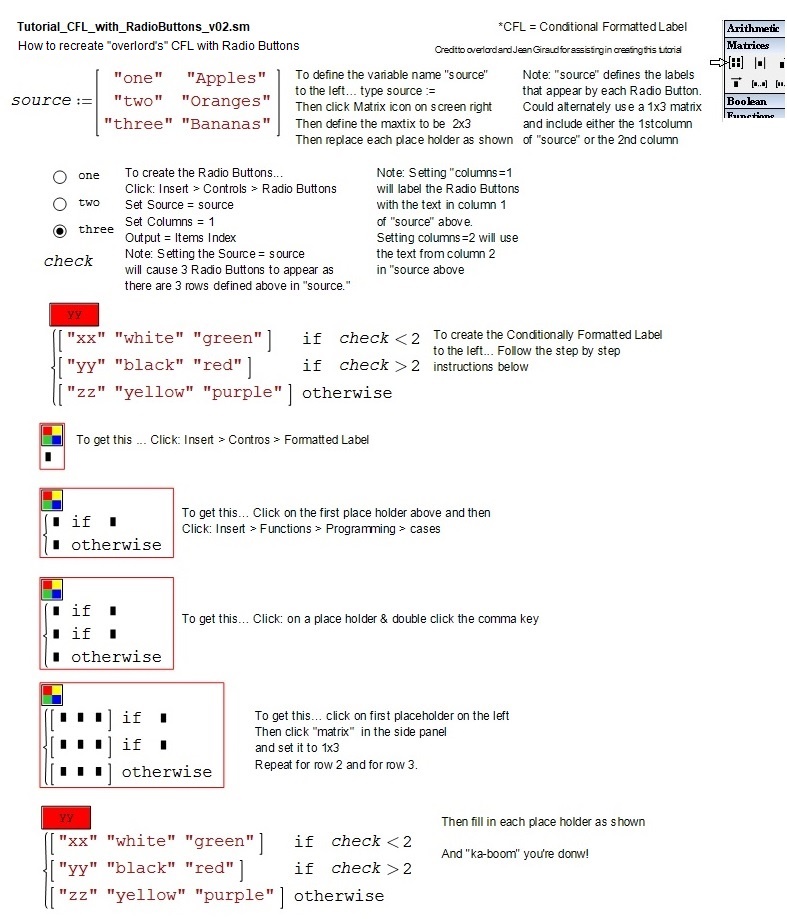

Ah Ha! Thanks for clarifying overlord. I can see I was a little mixed up on this.
I'll tweak the tutorial tomorrow... I'm done for today. Time for a glass of something :-)
Jean, that is certainly a more robust example.
Click sequence doesn't seem as clear to me however...
And some of the syntax... like double click the comma to add if lines to "case" ...
and a few other things I attempted to detail completely escaped me until you guys gave me guidance.
I'm sure it's in the examples, samples, and doc's somewhere but I just didn't discover such until you and overlord and others here on the forum were kind enough to point them out to me.
Good night folks... and thank you all for so much help.

Revised: How to recreate "overlord's" CFL with Radio Buttons
Credit to overlord and Jean Giraud for guiding me along the way.
This is a revision of the previous version in this thread.
Overlord noted some valuable points after that post and it's worth looking back to his post earlier in this thread...
So, this is my attempt to include reference to those points in the revised tutorial.
The SMath file with step by step instructions.
Tutorial_CFL_with_RadioButtons_v02.sm (15.78 KiB)已下载 1319 次。
Original by overlord: CFL with radiobuttons.sm
CFL with radiobuttons.sm (4.38 KiB)已下载 1279 次。
Maybe these step by step, click by click instructions will help a newbie along the way.
Please let me know of any corrections.
Thanks.
