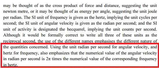

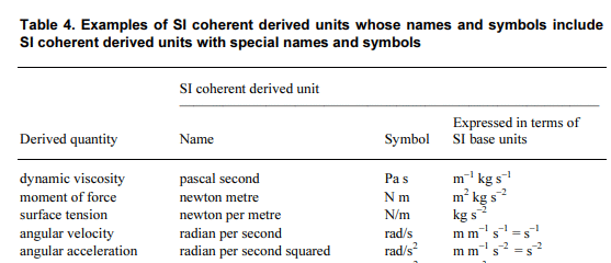

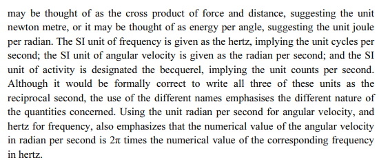

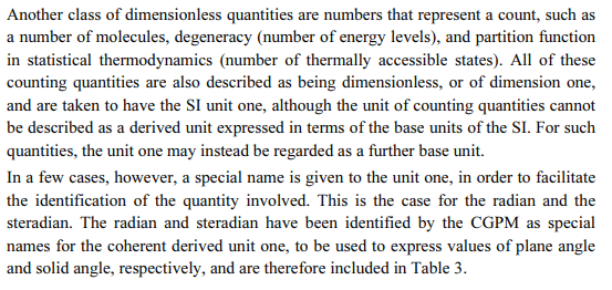

Nope. radian per second it is 1/s. In can't derive that from the animation, check the Official standard, from https://www.bipm.org/utils/common/pdf/si_brochure_8_en.pdf
Pages 119 - 120

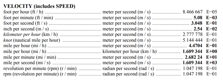

Thus, SMath it's correct. Maybe what your friend needs to use is rpm, which have also a correct definition in SMath. It isn't in the BIPM bureau but can find it at NIST: https://physics.nist.gov/cuu/pdf/sp811.pdf
Pages 119 - 120

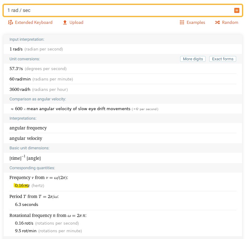

1rad/s reflects the speed of a flat angular motion [circular/elliptical motion]

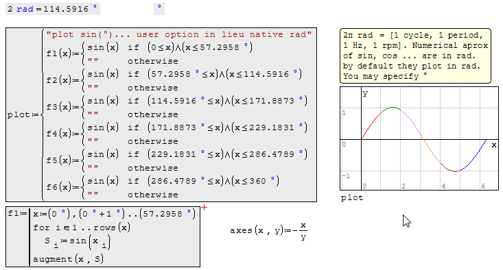

More confusing is the numerical approximation of sin(x), cos(x) ...
The argument 'x' is rad.

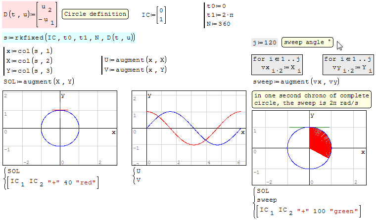

The visitors may complete the X_Y plot attached.
Maths sin(deg) plot.sm (17.61 KiB)已下载 1303 次。
See the line about Hz. Don't we need this in SMath Studio?

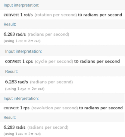

Naming rev or rot as 'rev:=2*Pi you can handle those values that appear in wolfram alpha.
From https://www.wolframalpha.com/input/?i=rot+%2Fs+in+rad%2Fs and similar:

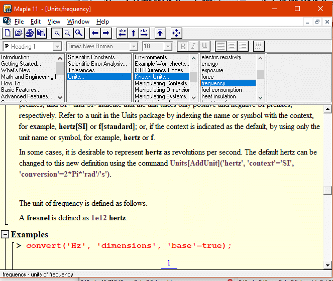

Finally, you can implement more complicate solutions, like this one in maple:
