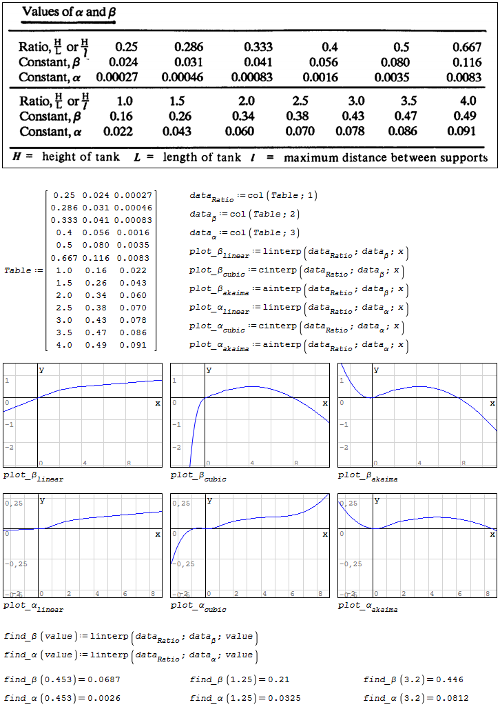

The aim is to obtain alpha and beta values from any intermediary values of H/L or H/l.
Thanks,
There are three different interpolation functions.
Your data seems to be lineear according to values.
Here is a demonstration of interpolation plots.
I also added functions to find β and α.
interpolation.sm (138.91 KiB) downloaded 1038 time(s).

WroteYou can use interpolation functions for that.
Your data seems to be linear according to values.
Thank you, Overlord. Much appreciated.

Thank you, Jean. "L" does not represent diameter. This table is for a rectangular tank design.

Obviously the data confirm the tank is not circular.
It may not be pure rectangular either vs deformation.
