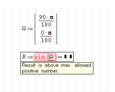

Hi guys (and girls of course if any)
can someone help me with the following error message and what is wrong here:
Thanks!
#2 已发布: 2021/5/5 21:29:38
churichuro
churichuro
29个赞,共79个帖子。
this does the trick!
Bruno Choquepata 2021/5/6 00:38:00

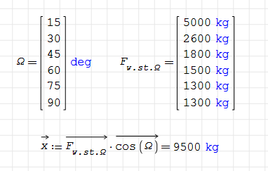

#8 已发布: 2021/5/6 19:47:25
dimart17@mainl.ru
dimart17@mainl.ru
0个赞,共4个帖子。
Now I need to multiply two arrays of values and get a third array of values. This is very easy. For some reason I get just one figure instead of array. What is wrong here and how to solve this?
#9 已发布: 2021/5/6 20:12:39
983个赞,共6,866个帖子。

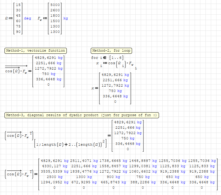

#11 已发布: 2021/5/6 20:28:20
600个赞,共1,381个帖子。
There are different methods you can use.
You either multiply with vectorize function. Sometimes this function will not avail.
Or multiply the elements piece by piece with for loop, in some cases this is the only way.
Or calculate dyadic product and take the transverse results of it. Why? because you can (swh).
