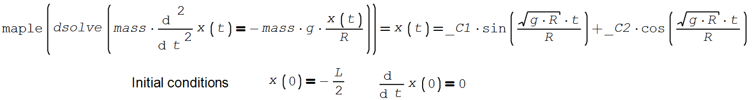

See please one ODE symbolic solution without IC
dsolve.sm (4.93 KiB)已下载 1508 次。

Thanks!
But no way to do so in SMath

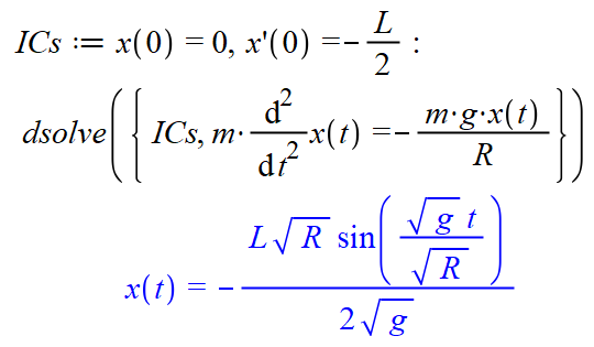

"L & m" are missing in dsolve result ?
m is missing in dsolve.
#5 已发布: 2023/7/1 14:48:44
1,139个赞,共1,805个帖子。
Hi Valery. Use Ctrl+Shift+K for write D(x)(0), which means x'(0)
Valery Ochkov 2023/7/2 04:05:00
#6 已发布: 2023/7/2 04:06:01
Valery Ochkov
Valery Ochkov
67个赞,共716个帖子。
Thanks!
dsolve-ICs.sm (10.61 KiB)已下载 1541 次。

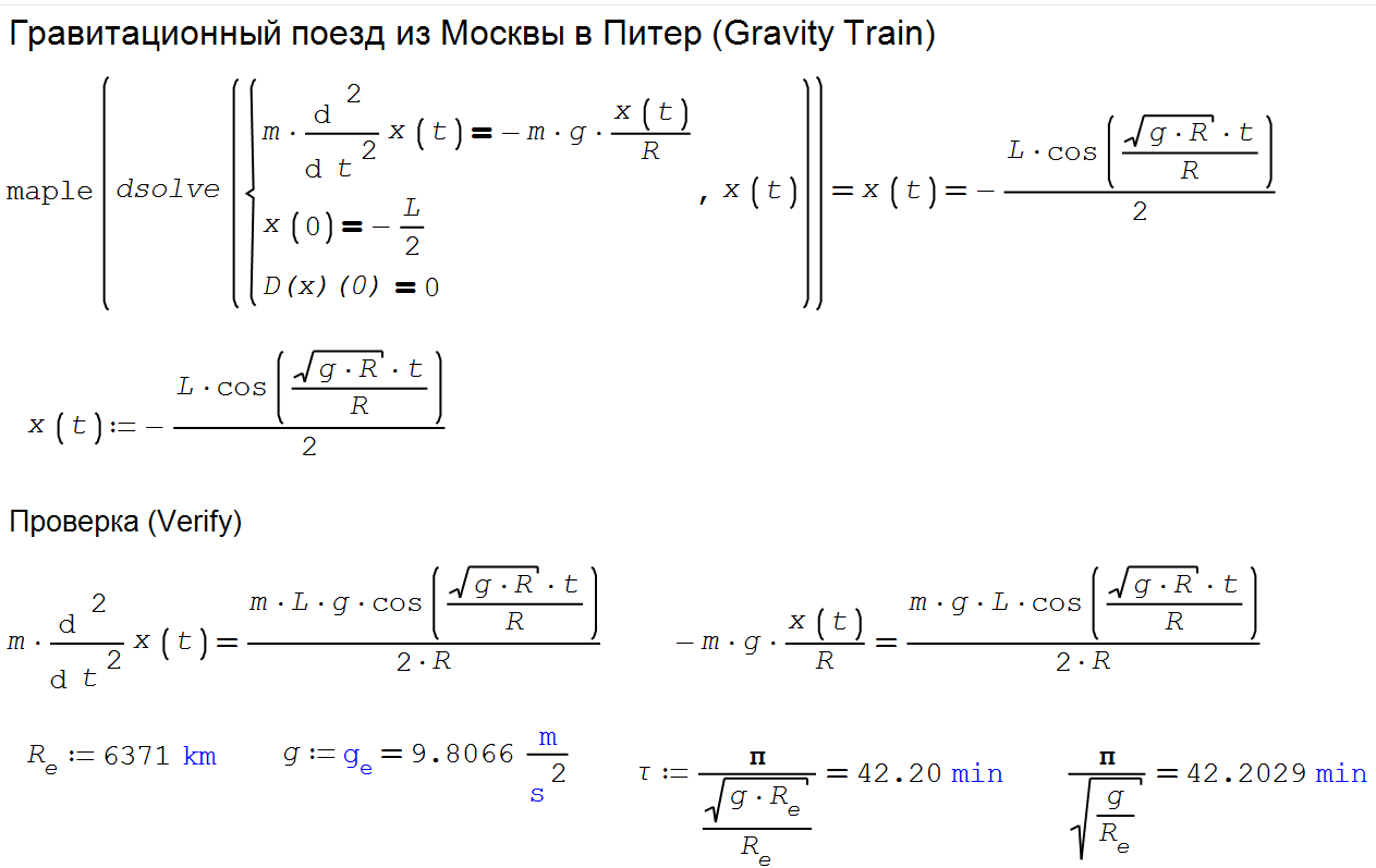

The distance between the cities added.
GravityTrain.sm (31.01 KiB)已下载 1467 次。
GravityTrain.pdf (233.1 KiB)已下载 937 次。

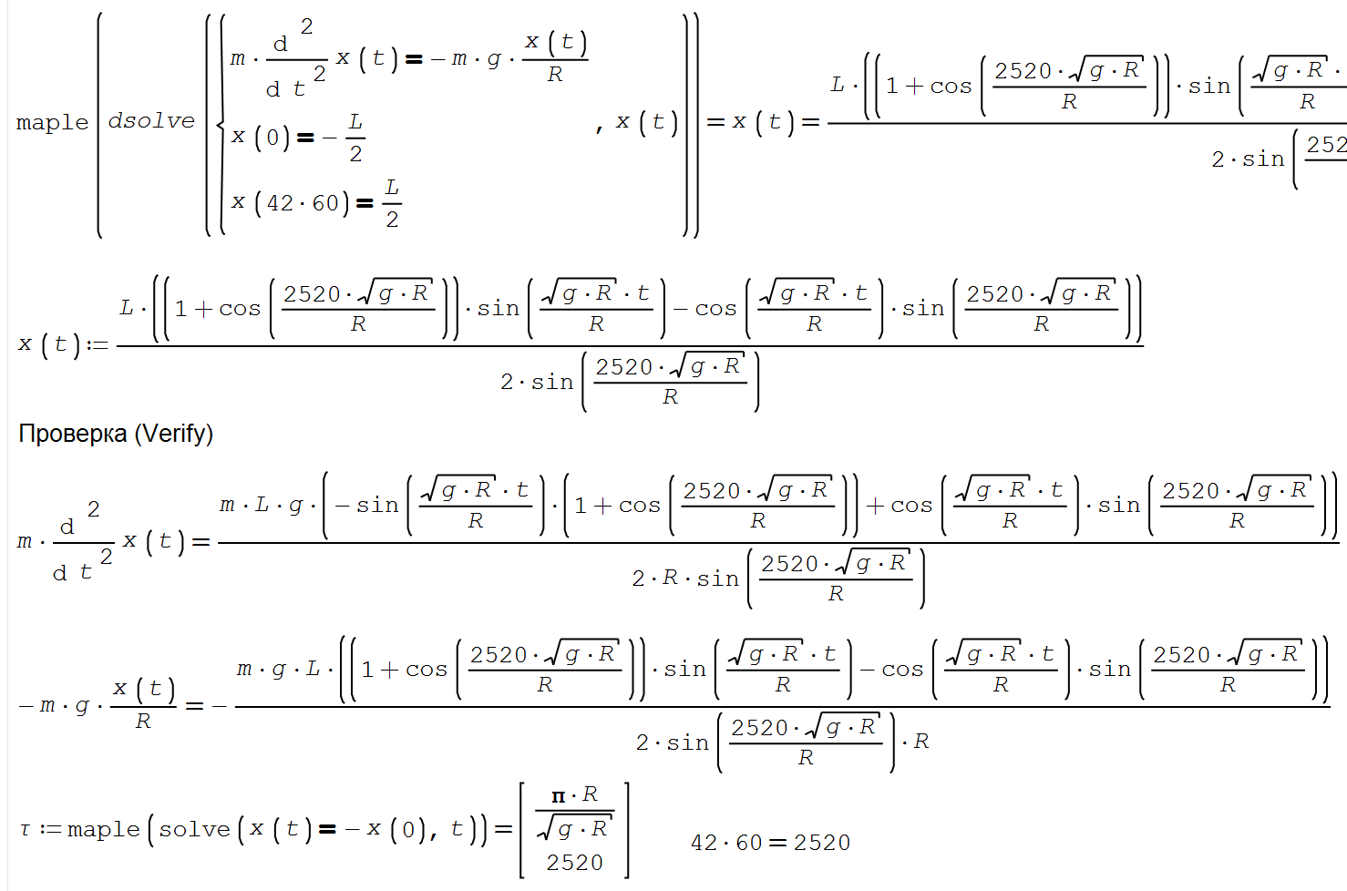

67个赞,共716个帖子。
The Boundary problem?
dsolve-Boundary.sm (17.01 KiB)已下载 1499 次。
