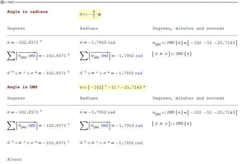

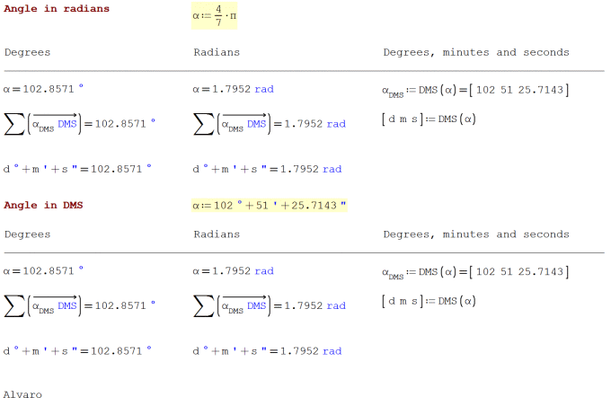

#5 Posted: 2019/2/23 12:16:22
1,106 likes in 1,784 posts.
Hi. Here, my workaround.
DMS.sm (17.67 KiB) downloaded 922 time(s).
frapuano 2019/2/23 12:28:00, sergio 2019/2/23 18:26:00

#8 Posted: 2019/2/23 14:06:06
Hmmm... The separate units use is interesting. I am so inexperienced with SMath I can't figure out how to enter the summation portion.
Hi. Try this as general rule for SMath sintaxis:
I think I will need to leave the negative angle input as [ -d -m -s ] with this approach. Would you agree?
Guess yes:
