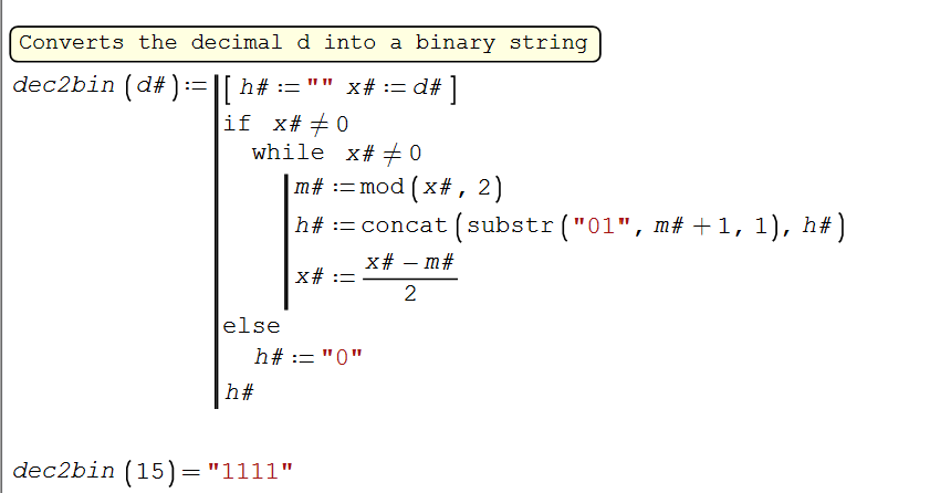

Epic dredge sorry. Functional, with all credit to @Razonar (source/author).
20221227 Dec2bin.sm (4.5 KiB)已下载 1738 次。

Thanks, nice source code.
algo(col) was designed to recover matrix col(s) string(s) to values.
Cheers ... Jean.
Maths Convert-dec2bin.sm (18.88 KiB)已下载 1632 次。

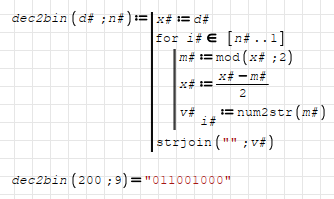

Modification of Razonar's dec2bin() should work well.
dec2bin(p,q) where p is the bit-field length and q is the decimal number to be converted.
Check the converted string's length and then pad the front with zeros to suit.

Here is what you have asked for.
dec2bin.sm (6.09 KiB)已下载 1614 次。

Thank you so much overlord, that is both elegant and perfect!
