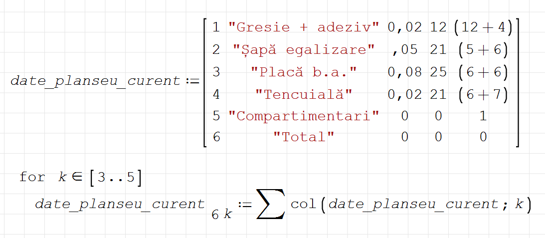

Hello guys,
I have a matrix with system of values in it. I want to sum up all the column.
Could you help me with this?
sumcomplexcolumn.sm (9.96 KiB)已下载 1395 次。

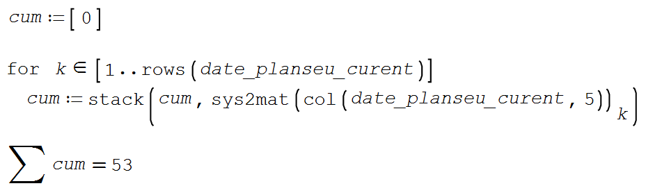

It's necessary convert each system of your 5th column to a matrix by sys2mat() function, then you can stack each matrix from 5th column and do the summation:
sumcomplexcolumn SOLVED.sm (12.77 KiB)已下载 1389 次。

Hi Sergio,
Of course, Oscar’s proposal is a very interesting one
May I make a simple suggestion: avoid the use of “sys” data and replace it with a simple sum, as in my appended file.

If the column's sums are aasked, here is a solution for keeping the answer inside the box...:d
![2023-10-15 13_17_06-SMath Solver - [sumcomplexcolumn (1).sm_].png](/zh-Hans-CN/files/Download/GH7pu8/2023-10-15-13_17_06-SMath-Solver---[sumcomplexcolumn-(1).sm_].png)
sumcomplexcolumn (1).sm (11.7 KiB)已下载 1395 次。
