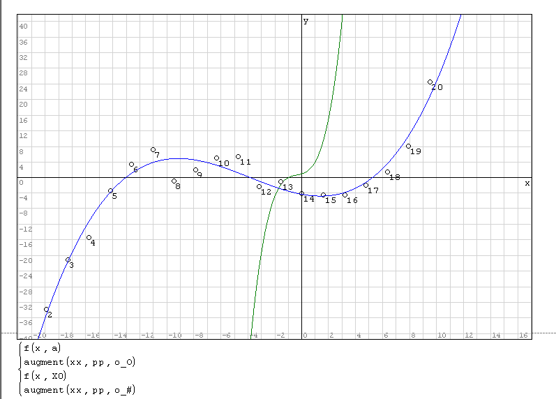

#26 已发布: 2012/10/6 11:02:10
325个赞和1个踩,共2,052个帖子。
Hello uni,
It is quite interesting that you've made it working with 20 points .
By the way, I've added the sum of squares - just to check how this sum reduces its value.
#27 已发布: 2012/10/6 11:17:30
1,558个赞,共1,868个帖子。
Yes, but initial value for a is X0 := stack(1, 1, 1, 1)
#28 已发布: 2012/10/6 12:20:33
Sorry, uni, my mistake . Graph distracted me
In this example - this is really amazing
If this could work for a bit more complicates functions - it would be really great .

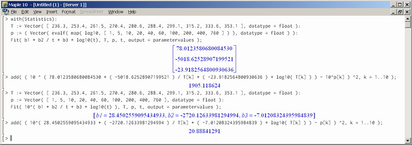

#34 已发布: 2012/10/8 05:42:03
1,558个赞,共1,868个帖子。
Radovan, it's really hard to get a solution using the Draghilev method. I do not know how to do it yet.
The solution here is: [28.4502559095434933, -2720.12633981294994, -7.01208324395984839]. Maybe later I'll be able to get it.

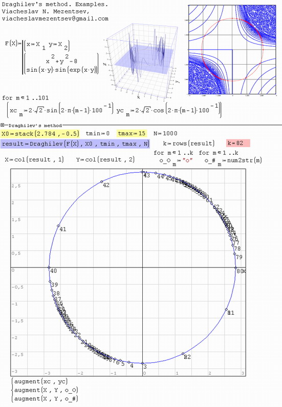

#38 已发布: 2012/10/11 01:01:39
1,558个赞,共1,868个帖子。
Example 5. Finding roots: System 4.
[MATH]sys(x^2+y^2-8=0;sin(x*y)*sin(exp(x*y))=0;2;1)[/MATH]
I made minor changes to simplify the calculations. Function has become more clear.
Calculation time: ~1.5 min
Roots: 80
Radovan Omorjan 2012/10/11 02:36:00
