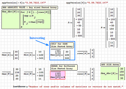

#32 已发布: 2021/8/22 10:28:04
NDTM Amarasekera
NDTM Amarasekera
130个赞,共352个帖子。
Vectorize function on Nested Array revisited.
Cheers!
