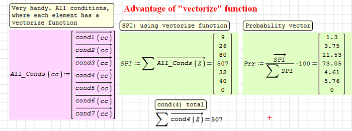

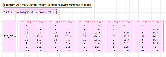

On the request of a fellow Engineer, the attached SM program was developed
to find the Standardized Precipitation Index (SPI).
58 years of daily precipitation data was available.
The SPI is widely used to analyze meteorological drought on a range of
time scales. There are proprietary software packages for this purpose.
The “vectorize” function was pretty handy and fast in analyzing various conditions.
SPI_cal-Rev & Improved-Final.sm (1.92 MiB)已下载 1518 次。
Rainfal_Data.xlsx (486.22 KiB)已下载 1135 次。
3位用户喜欢此帖子
Radovan Omorjan 2019/7/6 04:23:00, frapuano 2019/7/6 05:13:00, Davide Carpi 2019/7/6 11:20:00

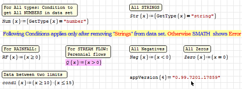

Attached file may be useful in handling data, where it may be
necessary to extract numerical values removing any strings, or
negative values, zeros etc.
Data Analysis Using Truth Table.sm (78.91 KiB)已下载 1475 次。

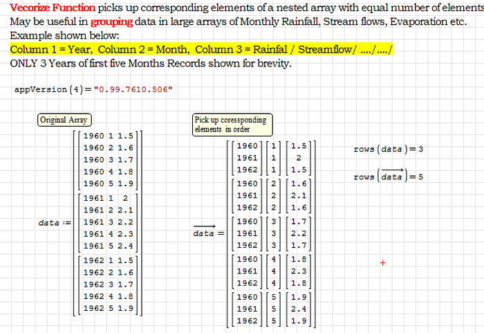

Advantage of vectorize function revisited.
Another practical example attached, with extensive use of the vectorize function. No loops used.
Comments by Martin, Jean, Razonar and others on this subject much appreciated.
Hope this may be useful for beginners.

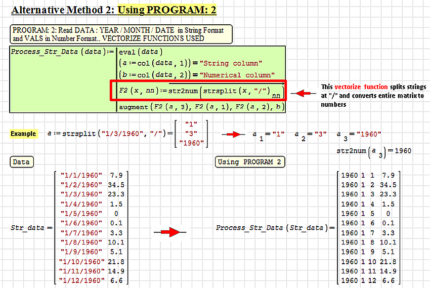

I have found this useful in day to day work.
Data imported from MS Excel sheet, and using "findrows" function to sum daily data to monthly totals.
sergio 2020/11/12 05:23:00

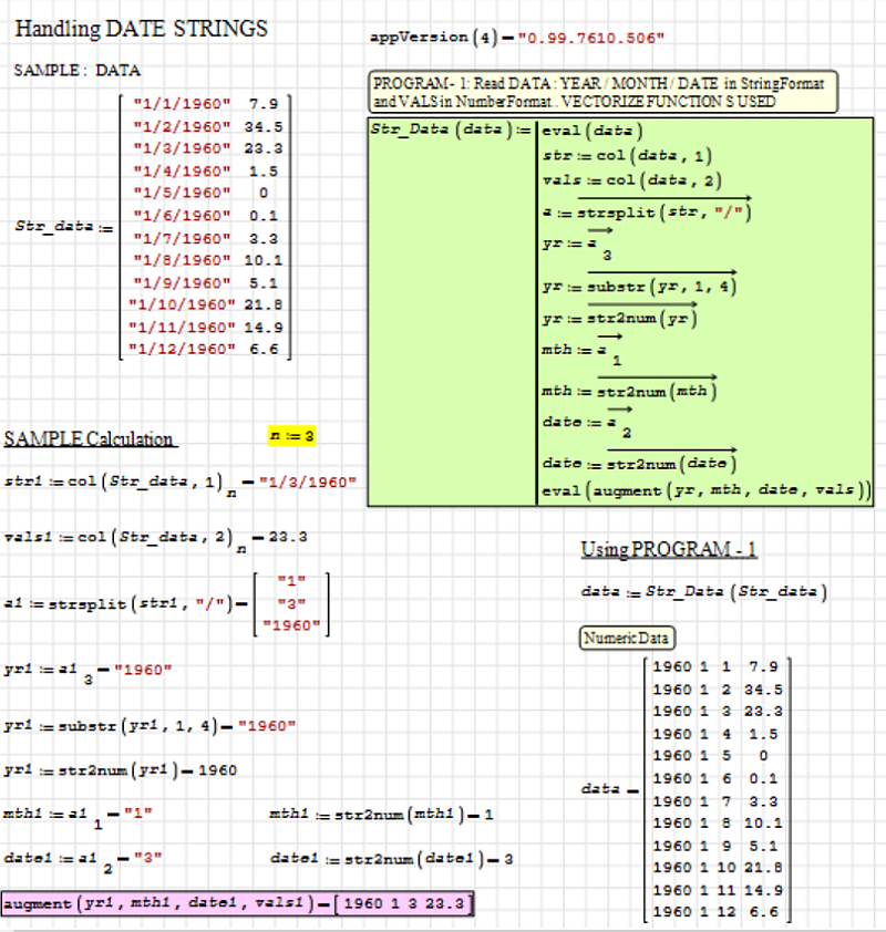

Attached is a simplified version of a project work for demonstration only.
The data file consists of date strings, and hence, had to be transformed into numeric.
Hope this may be useful for beginners. Vectorize function very useful in this exercise.
Handling DATE STRINGS.sm (16.17 KiB)已下载 1456 次。
sergio 2020/11/17 14:39:00
#10 已发布: 2020/11/16 20:48:19
983个赞,共6,866个帖子。
The secret is inside your nice piece of work ... superb, thanks.
Take care my Friend ... Jean

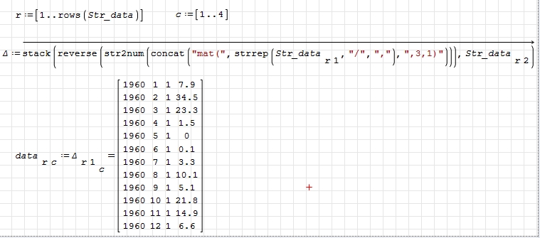

Hi. Handling data strings you have also this cheat for convert dates to numeric matrices.
Handling DATE STRINGS.sm (20.56 KiB)已下载 1392 次。
2位用户喜欢此帖子
sergio 2020/11/17 14:39:00, NDTM Amarasekera 2020/11/17 22:29:00
Revised program to handle date strings.
Handling DATE STRINGS+Alvaro.sm (43.62 KiB)已下载 1440 次。
Alvaro 2021/2/2 15:35:00
Thanks Collab for that most useful work.
Saved ... for future use.

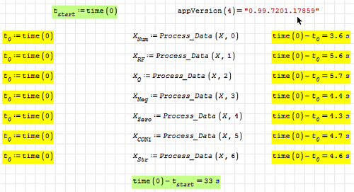

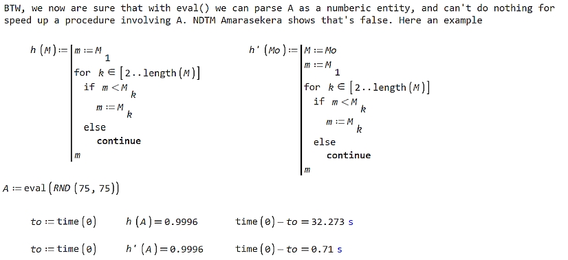

Hi Amarasekera. Yes, that one, thanks. The fact you're showing despite to me about the speed in procedures with arrays. In the attached some comments about the need to redefining M:=M where M is a matrix argument in a procedure.
EvalTest.sm (17.47 KiB)已下载 1426 次。
EvalTest.pdf (73.82 KiB)已下载 783 次。

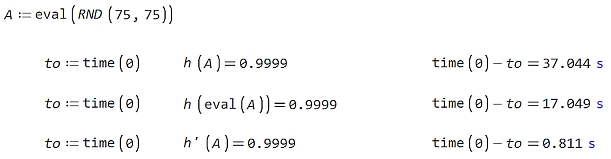

Alvaro,
Are you showing that by redefining Mo variable, within the program, it speeds it up 30 fold? That makes no sense
The only thing that remotely comes to mind is that M, being defined within the program structure as M:=Mo, is not having to read for the variable from the outside.
Have you, or anyone else, tried this on other programs?
#19 已发布: 2021/2/2 19:54:30
1,139个赞,共1,805个帖子。
Alvaro,
Yes. Please, try to check in your environment if this is true also. (Notice that my laptop is very slow, because always is running something else or overloaded by some other procedures)
Yes. For this was the issue in the original Amarasekera work, and why I say that he was the first showing this behavior. But I have other codes where using M:=M speed up slow procedures. Actually anything with a loop over a matrix.
Here intermediate timing result, which I can't explain
#20 已发布: 2021/2/2 22:13:47
