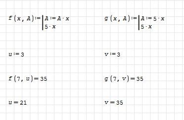

I am expecting the global variable value to change and maintain the change after exiting the function.
Example

Hi. The only way I know for a function to modify a variable is to pass it by reference to the function.

Hi Alvaro,
Thank you for your reply. How do I do that? Could you share some sample.
#4 已发布: 2021/7/1 00:12:28
1,139个赞,共1,805个帖子。
Hi.
example_by_ref.sm (4.86 KiB)已下载 1260 次。
