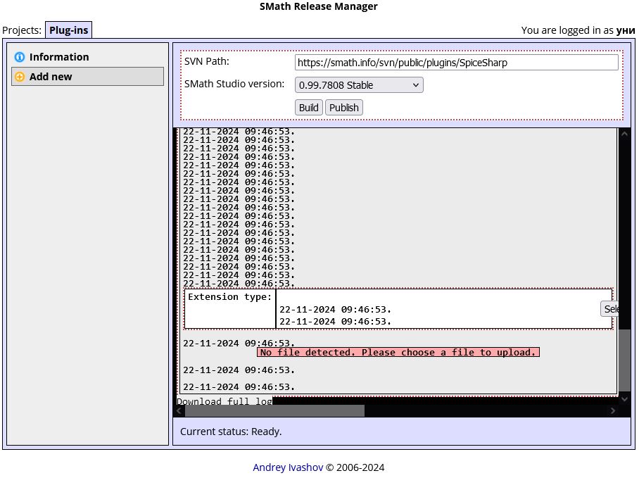

I can't publish the plugin

Reproduced. Working to fix it.
#4 已发布: 2024/11/22 22:15:16
2,344个赞,共4,057个帖子。
组: Super Administrator
Issue is troubleshot.
The reason is that the file of the plug-in is 35.5 MB which is the largest plugin right now. Server does not accept such amount of bytes because of security reasons.
Current maximum request limit is 30,000,000 bytes, which is approximately 28.6 MB.
I'm checking what can be done here...

Possibly the same issue with ImageEditRegion?

Yep, it is 30.2MB, while we are accepting not more than 28.6MB.
It will be fixed, but because of our development cycle (i.e. "temporary everything is broken" but for the good reason!) it may take up to a week...
I will let you know as soon as it is finally handled.

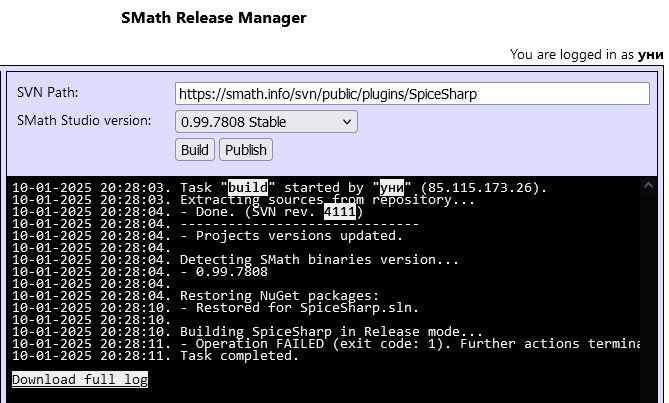

There is no log, the reason is unknown.

If you click on the Download full log link at the bottom you'll see the following error:
"error NETSDK1050: The version of Microsoft.NET.Sdk used by this project is insufficient to support references to libraries targeting .NET Standard 1.5 or higher. Please install version 2.0 or higher of the .NET Core SDK."
Will try to install latest .Net SDK.
As I wrote earlier, this log has not been displayed for me for many years. When I try to download it, I get an error: File not found.

Sorry, forgot about it.
Building a plugin fixed, but as I see an output package contains folders like cs, de, es, fr, it etc... - this will break plugin installation. This is known issue but requires new SMath Studio build.
The best solution for now is to exclude these folders from output (they must be a part of third-party Nuget I think).
I'm not sure I can control this. These resources appear automatically. I don't remember which settings are responsible for this, but they are still not available to me. I can insert dependent packages in the sources instead of packages, but it's too complicated.

Done.
Spice# plugin can be built, uploaded and installed now.
To make things easier I've converted project to a new style and hope you like it.
Please try.

Yes, now everything works and I can expand the functionality of the plugin. Thank you.
The plugin is now available in the gallery.
