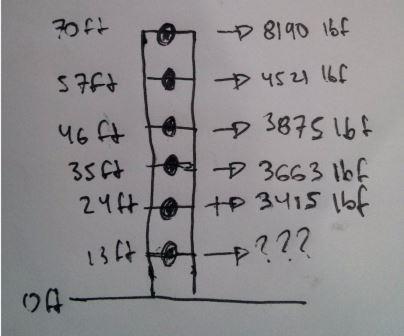

#9 Posted: 2015/10/30 17:25:24
Ernesto
Ernesto
13 likes in 74 posts.
I was picturing the system like this:
Forgive my ridiculous handwriting.
#10 Posted: 2015/10/30 19:06:19
Ryan Freund
Ryan Freund
20 likes in 339 posts.
Sorry, busy day today. Looks like you guys have it figured out.
It is typical in my region to say "shear" because it is a 'shear'wall or the diaphragm shear due to lateral loads. However you are are correct, these are lateral forces (wind, EQ).
Thanks again for your participation.
I will give your functions and graph a try as they look much better than mine, but it appears that my "for" loop finally had the right answer (see "Summing Overturning Moments_2.sm")
