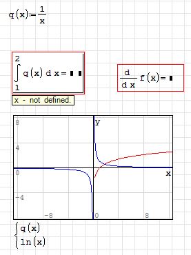

The remaining of the work sheet may not work at all.
#4 已发布: 2016/5/21 09:13:23
983个赞,共6,866个帖子。
read more

#7 已发布: 2016/5/21 21:45:44
983个赞,共6,866个帖子。
If version(s) past 5346 disable the integration operator,
to me : it is a bug by definition as exemplified earlier.
