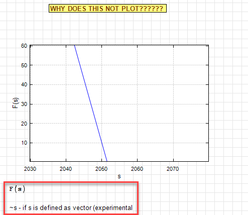

My Mathcad brain causes me to misunderstand some SMATH syntax. The is especially true in XY-Plots. I have created two function: F(s) and F1(s), which is discontinuous. If I redefine the functions as vectors and use augment to define the x-axis, the plots look okay. However, when I try to plot just the function, it does not work. These plots do not create a trace list as with the vector versions. F(s) just doesn’t plot. F1(s) also doesn’t plot, plus it gives an error.
In short, how do I plot simple functions?

Hi JReg. If I'm not wrong, just try to plot both with an undefined variable like F(so) and F1(so). The problem is that 's' is a vector.

Due to the implementation features, you can't use the function argument the same way you do it in Mathcad. The component allows you to use a vector variable if you add a tilde before the name.
