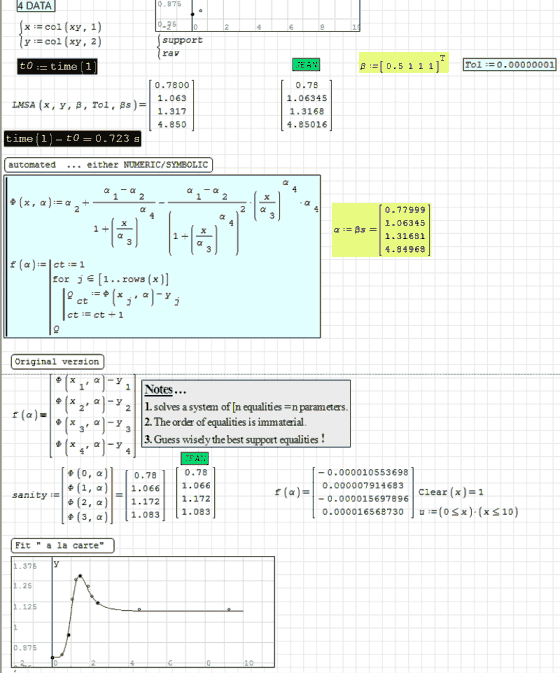

Reviewing the Levenberg Marquardt Method with a Jacobian matrix for finite differences,
solving an example taken from the website:
http://support.ptc.com/help/mathcad/en/index.html#page/PTC_Mathcad_Help/example_using_minerr_for_nonlinear_least_squares_fitting.htm .
Algorithm_Levenberg_M_with_DF_SS7251.sm (210.01 KiB)已下载 1354 次。
Algorithm_Levenberg_M_with_DF_SS7251.pdf (569.73 KiB)已下载 849 次。

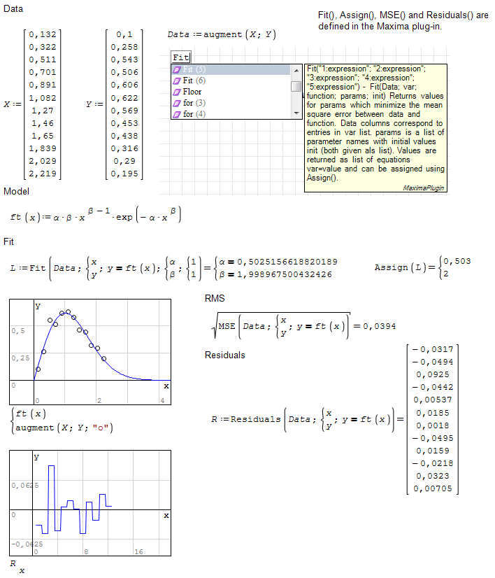

Solution using the Maxima package lsquares via the interface functions of the Maxima plugin
fit1.sm (29.42 KiB)已下载 1335 次。
2位用户喜欢此帖子

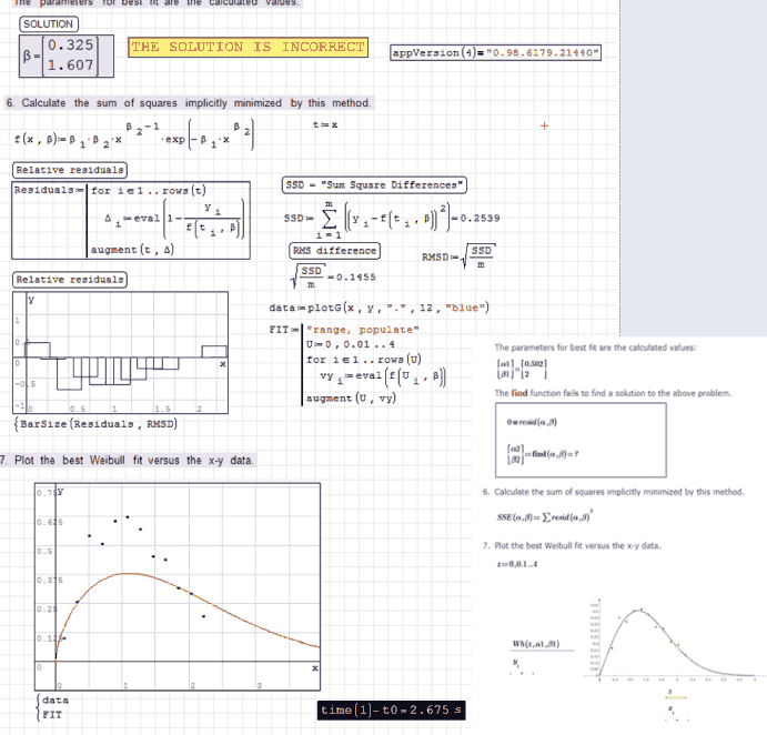

Thanks: Carlos, Martin.
SS 6179 does not complain but still pedaling in 10 min ???
1. in Mathcad [8 Pro ... 11] type ERR= after Minerr
ERR is undocumented = SSD [discovered by Paul W.]
2. alternate to corr, SSD sometimes meaningless [Viod ratio, Verhulst].
3. Often, the best fit is Conjugate Gradient.
Genfit VoidRatio.sm (65.37 KiB)已下载 1280 次。
Genfit Verhulst.sm (56.28 KiB)已下载 1296 次。
Genfit Weibull.sm (54.08 KiB)已下载 1294 次。

Hello Jean:
I tried to run the algorithm of Levenberg Marquardt, in the version of SS6179,
but it inevitably fails, giving an incorrect solution.
It seems that the error could be in some operation where a single value vector
is produced. Could you take a look to see if you can doctorate ?.
I post again the version of the algorithm in SS7251 with some minor changes.
Algorithm_Levenberg_M_with_DF_SS6179.sm (513.58 KiB)已下载 1370 次。
Algorithm_Levenberg_M_with_DF_SS7251_R1.sm (209.94 KiB)已下载 1385 次。

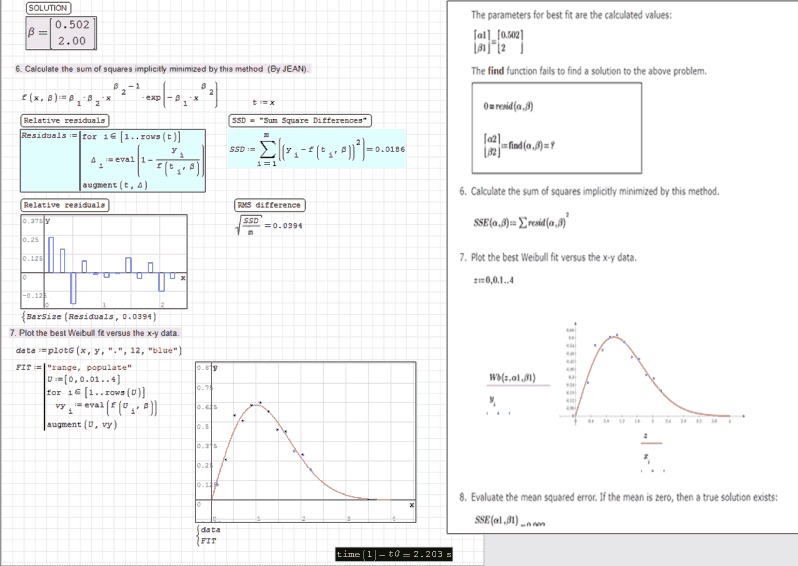

Hola Carlos. Just check the code from the SS6179 version, in the while not(stop) loop, the line with A:=J^T*f is wrong, it must to be A:=J^T*J.
NDTM Amarasekera 2019/12/27 07:17:00
#11 已发布: 2019/12/27 15:47:32
983个赞,共6,866个帖子。
Thanks Alvaro ... doctored !
Weibull LM [0.1,1] 1 min
Weibull CG [0.1,1] 2.3 sec ... ½ max residual deviation
Carlos, your very original LM [Pharmacokinetics] works faster.
an it be compacted algo style ... tried not to avail ?
Hola ! Avaro, Carlos ... Jean
Genfit Weibull [LM_Iteretive CG].sm (437.44 KiB)已下载 1157 次。
Genfit [Algo Minimize(L-M)].sm (116.99 KiB)已下载 1152 次。
Hola Alvaro.
Muchas gracias por tu corrección.
Cuando copie y pegue directamente el codigo de SS7251 a SS6179 daba el error de
"Ecuacion demasiado larga para visualizarla" con un tiempo de ejecusion de mas de 7 minutos,
por lo que opté por copiar manualmente el codigo, pensando que las declaraciones eran interpretados erroneamente, y
fue cuando copie mal la formula.
Hello Alvaro.
Thank you very much for your correction.
When copying and pasting directly the code from SS7251 to SS6179 it gave the error of
"Equation too long to display" with an execution time of more than 7 minutes,
So I chose to manually copy the code, thinking that the statements were misinterpreted, and
It was when I copied the formula badly.
Muchas gracias tambien a Jean por su apoyo y sus comentarios tan acertados.

Hola Jean!
Levenberg Marquardt's second algorithm in SS7251 does solve the example. All data
with a tolerance of 10 ^ -16 can be used, or 4 selected data with a tolerance of
10 ^ -8 can be used, in both cases, the starting vector is [0.5 1 1 1].
LM2A_as_a_Function_SS7251_R1.pdf (798.89 KiB)已下载 863 次。
LM2A_as_a_Function_SS7251_R1.sm (205.62 KiB)已下载 1355 次。

#20 已发布: 2020/1/16 15:35:31
983个赞,共6,866个帖子。
Jean, I tell you that I take the results you show in your exercises as the exact or correct ones
They are all correct, good fit from model.
There are many more techniques to best fit by region(s)
The last example SS 6179 spits the fit very fast vs other
solvable previous examples ... supports tol 0.00000001.
Comfort yourself: model fit needs no more than 6 decimals
or less ... from zillions done.
Thanks Carlos for your doctoring expertise.
Genfit 000000000000 L-M AUTOMATED Carlos 20200115 [Exampless].sm (211.49 KiB)已下载 1135 次。
