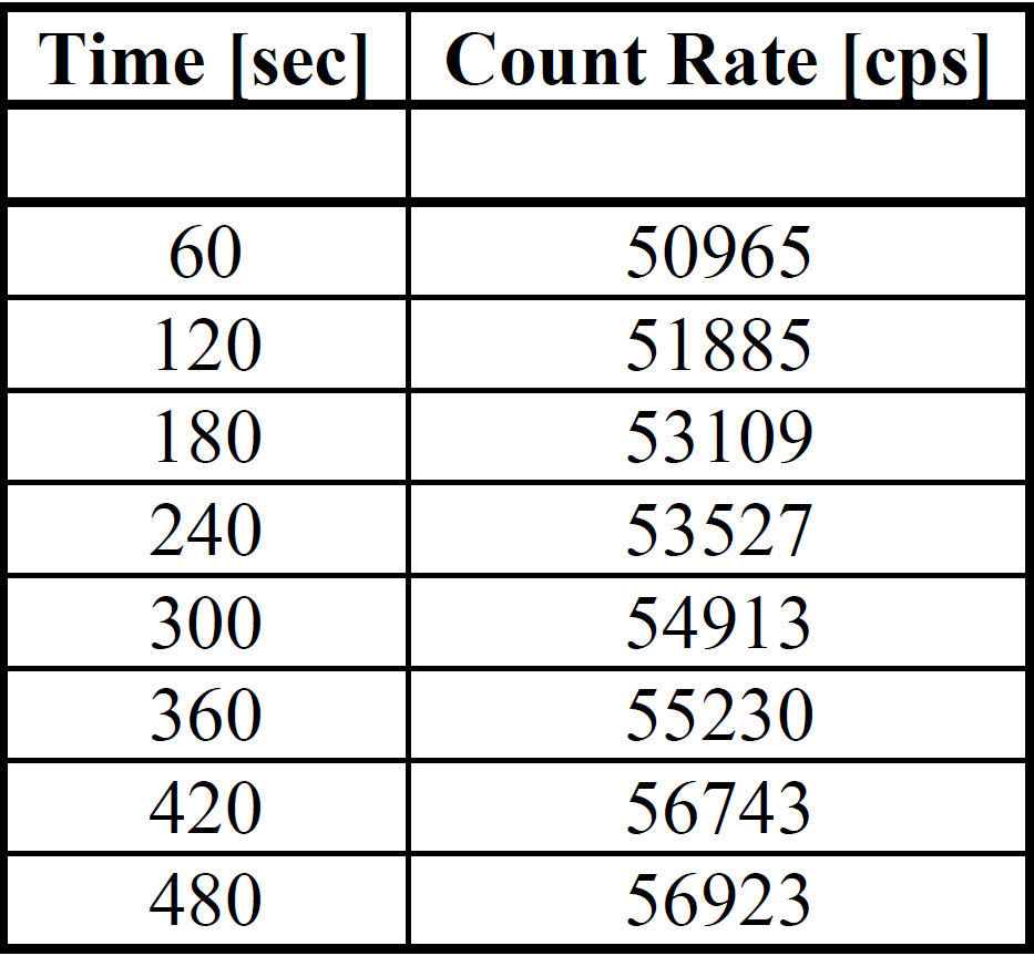

hi i have a table of values [R(t=60)=50965] with no obvious pattern and i need to create a function to fit into the formula
1/T = d (ln(R(t)) / dt
my thought was to make S(t)=ln(R(t)) and do d(S(t))/dt but i dont know how to turn a bunch of values into a function in smath and excel doesnt understand the function properly (i left out the last value and did auto complete and it was too far off)
R(t) is in counts per second
and i am solving for T

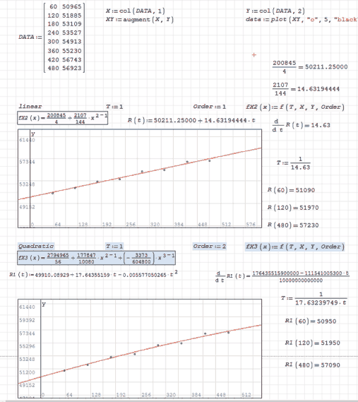

#6 已发布: 2019/11/27 21:14:47
983个赞,共6,866个帖子。
... in your original scale XY.
Data.sm (40.67 KiB)已下载 1165 次。

#8 已发布: 2019/11/28 00:03:25
983个赞,共6,866个帖子。
thank you so much
as much as I would like to say part b of the question I need to do my own homework I just couldn't understand how to get the equation of that line
1. You mean equation of the straight red line of the first plot ?
2. Or: the piece wise linterp between the support points ?
linterp, cinterp, ainterp are built-in Smath from f(x) menu.
The straight line in [1] can be manipulated a bit from statistical methods [Not Smath built-in].
Also, if you don't like the rough bifurcation at the supports
points, easy to fillet for smooth path.
No more need for the first replies before the last attachment,
then will be removed.

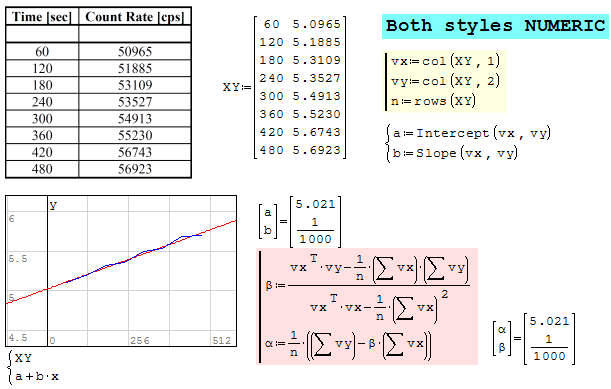

#9 已发布: 2019/11/28 01:35:47
CBG
CBG
78个赞,共312个帖子。
I think you can also use the least-squares method to find the equation that best fits your data.
Ajust_by_Last_Square_Selection_Engineering_studente.sm (62.08 KiB)已下载 1254 次。

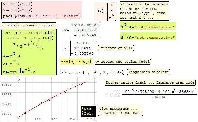

#10 已发布: 2019/11/28 08:55:51
983个赞,共6,866个帖子。
Here is Cholesky [Least Squares], otherwise.
Ge sensor [Germanium] is an exceptional application.
Genfit 0 Ge SubCryogenic.sm (39.2 KiB)已下载 1119 次。
Data.sm (54.7 KiB)已下载 1190 次。
