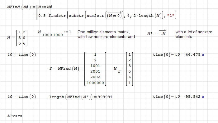

SMath论坛 SMath Studio Samples find function 1页(1条) find function - 消息 转到最后一个帖子 #1 已发布: 2021/4/26 09:46:25 Alvaro 1,139个赞,共1,805个帖子。 组: User Hi. find it's very useful for numeric procedures. For instance, there are a lot of code in matlab which use it. This is the faster find function that I can ... find.find.sm (8.3 KiB)已下载 1410 次。Best regards.Alvaro. 1位用户喜欢此帖子sergio 2021/4/26 14:34:00 1页(1条) 有新帖 无新帖
