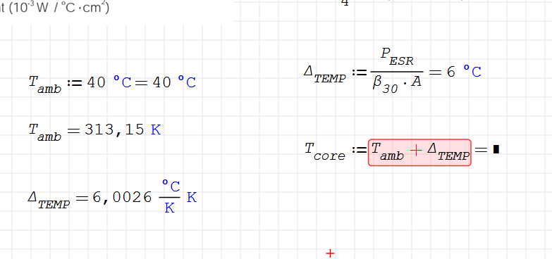

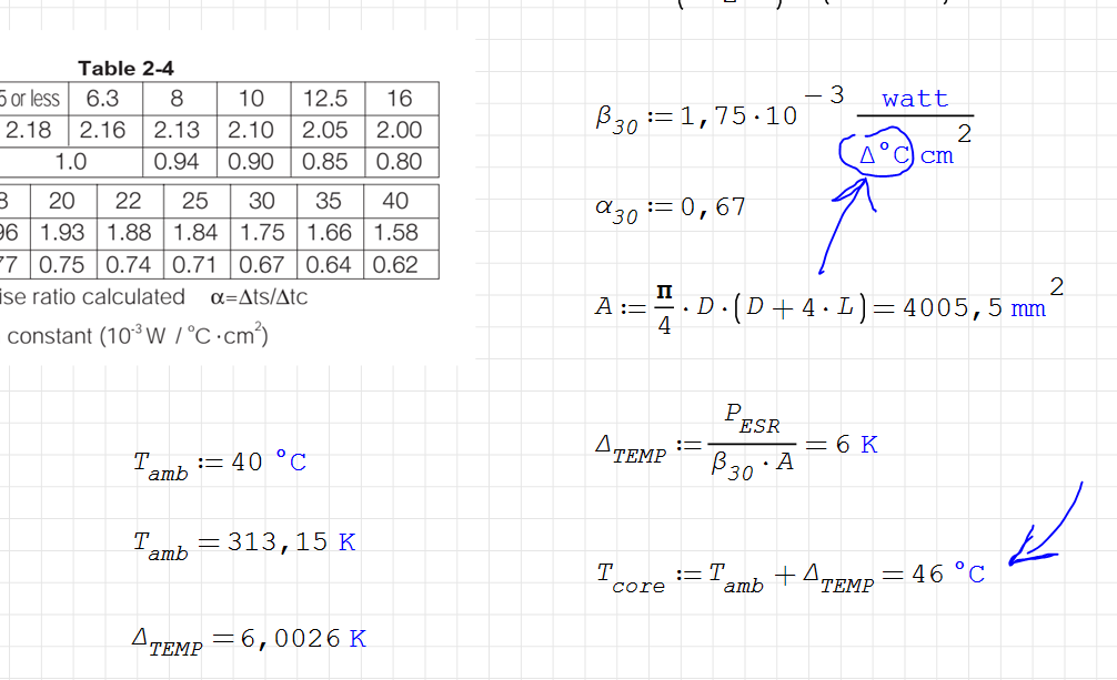

Hello, I would like to consult you
I define a temperature in degrees Centigrade, when I call it it looks like Kelvin degrees and then I can't make a sum because it tells me they are two different units. How can I do so that the defined temperature is maintained in every calculation in the unit that defined it?
Attached image capture of the problem.
Thank you
Thank you
There are many posts on the Forum about handling tempereture units. See for example this one.
