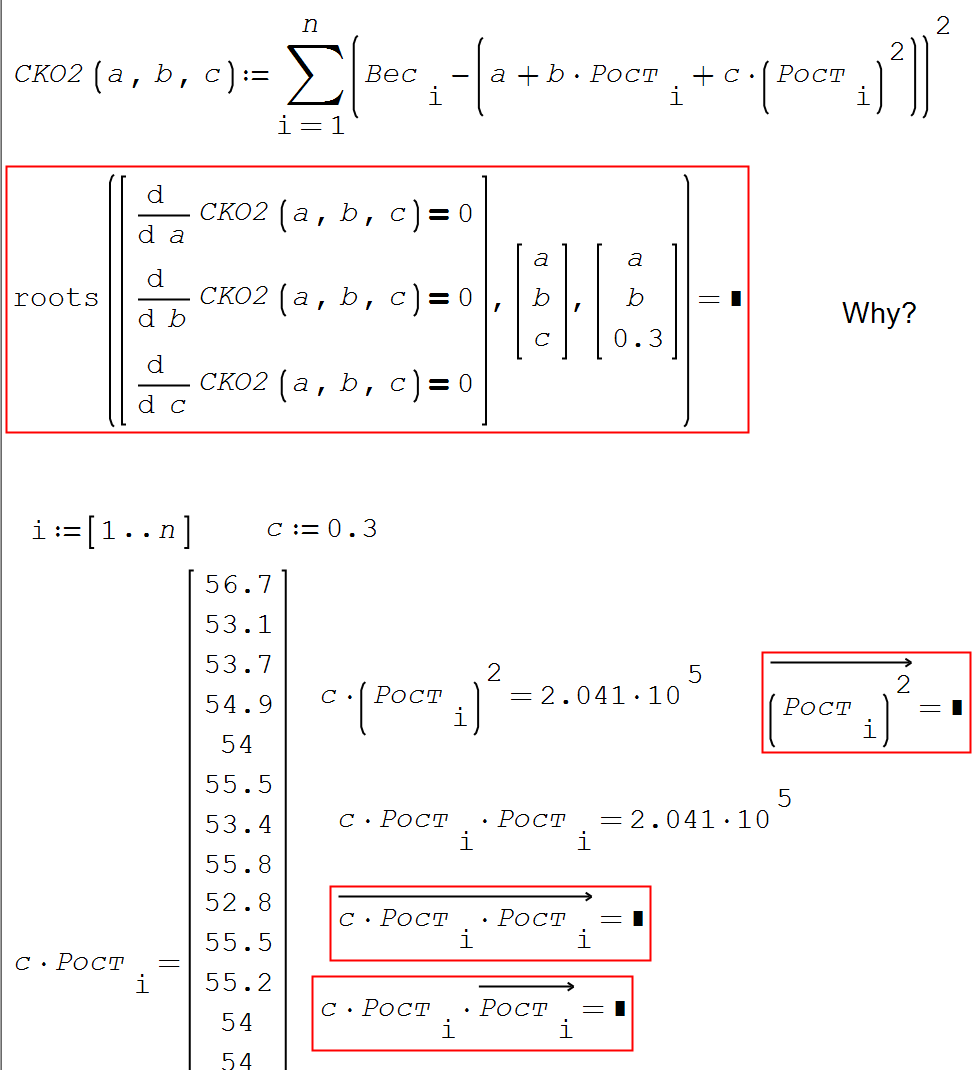

See please the end of the attached file.
6-1-Mister-Class.sm (33.29 KiB)已下载 1298 次。
#2 已发布: 2023/10/14 21:38:32
983个赞,共6,866个帖子。
Triplet roots ... FindRoot not doctored.

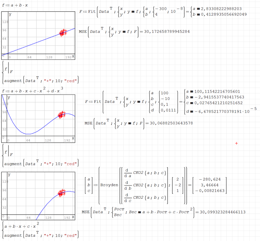

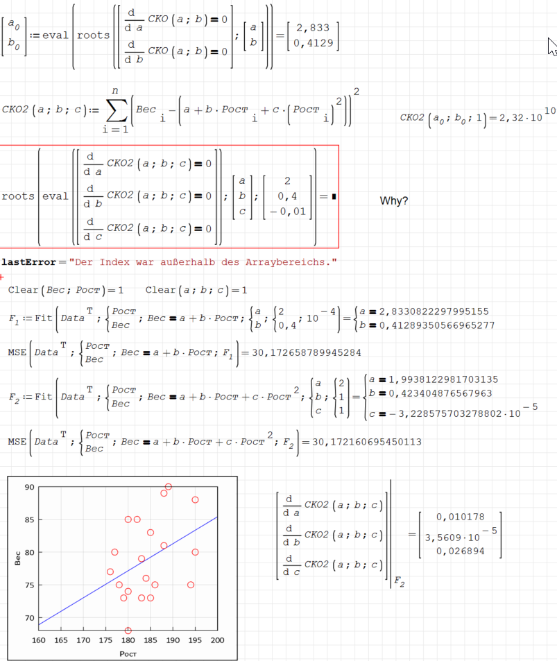

#3 已发布: 2023/10/14 21:42:14
1,362个赞,共2,276个帖子。
The first error can be handled by wrapping the function in eval(). For the second one this does not help.
I take the opportunity to advertise the Maxima Fit() function.
It is explained in https://doi.org/10.25933/opus4-2949 chapter 6 (English) and in https://doi.org/10.25933/opus4-2948, chapter 9 (German).
6-1-Mister-Class Kr.sm (56.11 KiB)已下载 1353 次。

1,362个赞,共2,276个帖子。
There is not much sense in fitting functions with many degrees of freedom to data containing not much information. Any function which goes through the centroid of the data points will come up with a similar MSE.
Is the second result really the best just because of it's lowest MSE?

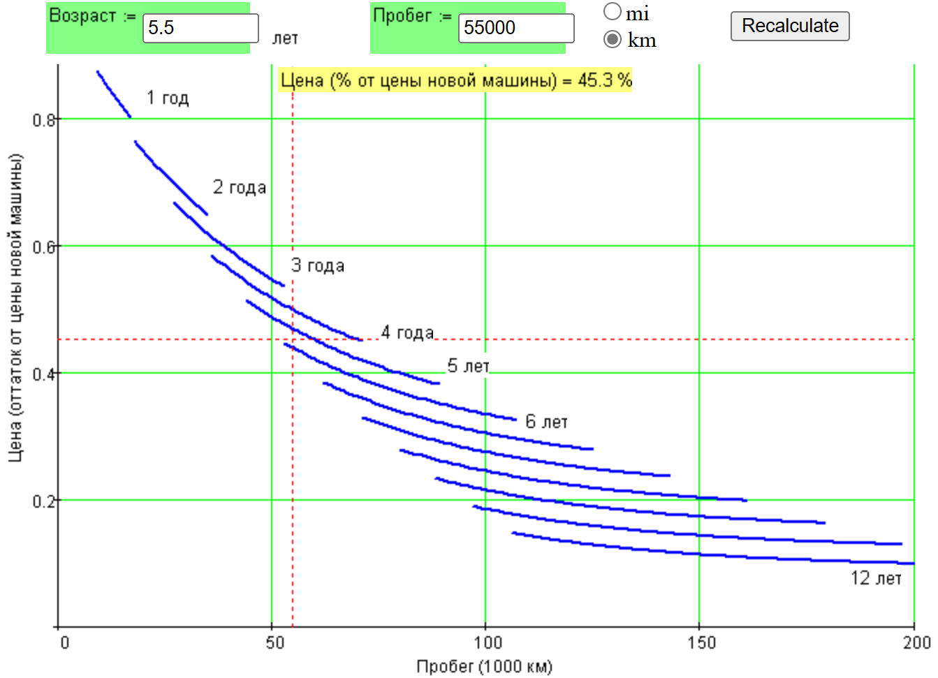

And what about 3D fitting in SMath?
See please my old problem in Mathcad
http://twt.mpei.ac.ru/ochkov/car/c_e.html
Online calculation
http://twt.mpei.ac.ru/MCS/Worksheets/old-car.xmcd

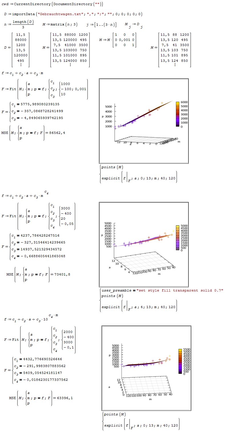

#14 已发布: 2023/10/16 05:57:28
1,362个赞,共2,276个帖子。
The second and third fit aren't really robust (quite some dependence on initial guesses)
Gebrauchtwagen.txt (729 B)已下载 963 次。
Gebrauchtwagen.sm (90.47 KiB)已下载 1378 次。

#16 已发布: 2023/10/16 12:48:56
1,139个赞,共1,805个帖子。
Online calculation
Another way, from the same previous post .
fit cars.sm (83.96 KiB)已下载 1386 次。
#17 已发布: 2023/10/16 13:45:10
Valery Ochkov
Valery Ochkov
67个赞,共716个帖子。
Thanks!
But the last plot must be so
#18 已发布: 2023/10/16 15:32:33
1,362个赞,共2,276个帖子。
Wunderbar!
Send me please the M matrix as sm-file!
The data is from your website. I copy-pasted the table to a new text file and imported it. Just use the files provided in my post.
As to the last plot: I guess the mileage limits of the individual lines are taken from the minimum and maximum slope observed in the age-mileage plot (fig.2 in your reference)?
Do you see any particular problem or do you just want the work getting done?
