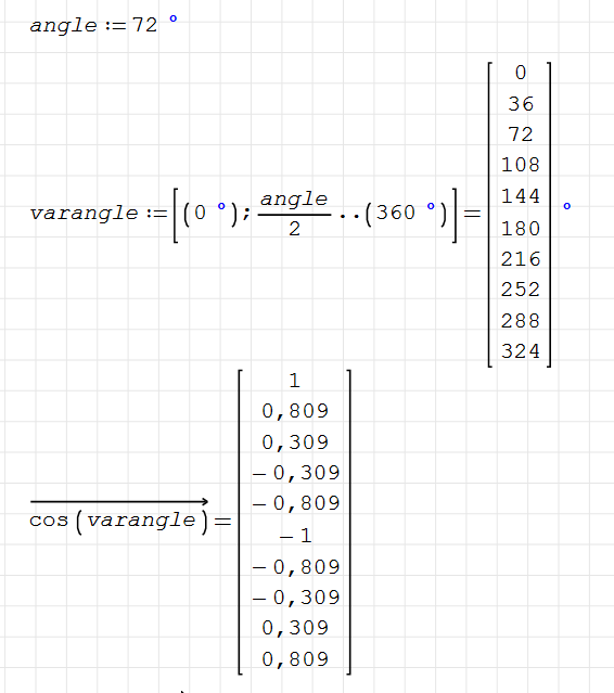

I'm trying to convert some old Mathcad files into SMath but am stuck with what must be an elementary problem, I've looked at various tutorials but can't find a solution, no doubt due to my own incompetence.
I am defining the following variables: angle:=72 and varangle:= 0, angle/2..360
In Mathcad if I then define: test(varangle):= cos(varangle) the output of test(varangle) displays correctly in a column.
If I try the same in SMath I receive either an 'argument must be scalar' or 'fill in all empty elements' error.
Thanks for any advice.
Screenshots of Mathcad and SMath attached.
btw, great software.
Mathcad - output.pdf (26.44 KiB) downloaded 789 time(s).

Correct me if i'm wrong, trigonometric functions don't support arrays currently.
For now, you can do something like this.
cosinOfArray.sm (5.04 KiB) downloaded 1550 time(s).

You can convert the vector into a system (by w3b5urf3r_reloaded)
Regards, Ber7
https://smath.com/wiki/GetFile.aspx?File=cosinOfArray%5b1%5d.rar

did arrays appear in trigonometric functions?
#7 Posted: 2024/9/28 16:09:41
126 likes in 341 posts.
now you can use the "vectorize" function, which you also find in the side panel, and perform the trigonometric function element by element.

An alternative to the vectorize() function is the use of index vectors.
They, however, only work if they are used in a definition.
Worksheet1.sm (5.28 KiB) downloaded 1307 time(s).
