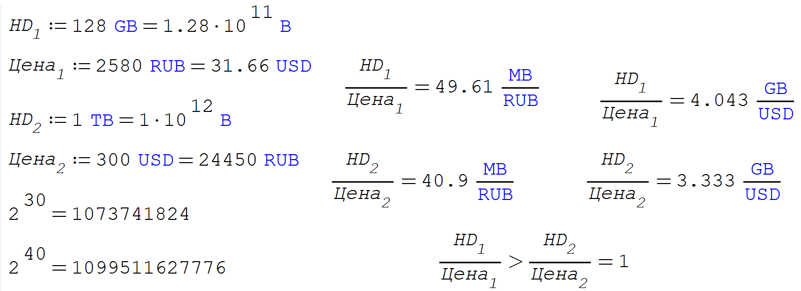

#4 Posted: 2023/4/24 12:01:03
Valery Ochkov
Valery Ochkov
66 likes in 682 posts.
Click to enlarge
Thanks!
See my first calculation
