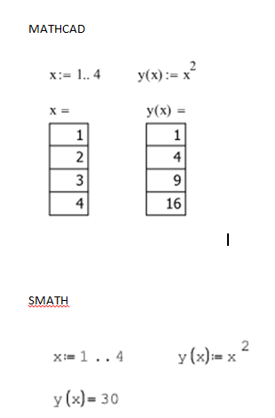

Please help me that how to generate series or table with variable having power.
In Mathcad it is very simple
a simple calcs has been shown belwo with a variable x having power 2. In mathcad it y(x) series can be easily generated, but smath results are not same.
So guide me that how to generate similar calcs in smath.

... in the attached, where you have Vectorise(f,zoom), try to write
Z:=f(zoom) under the vectorise operator and see if it works.
But don't zap the existing working Z:=Vectorise(f,zoom).
