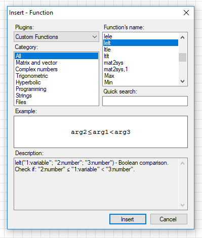

typing more boolean alike without that irritating clips to appear
Just to clarify, parentheses in booleans were introduced because often calculations of newbies were affected of wrong statements in if() functions, where you might be tempted to use something like a
BTW, if neeeded, in Custom functions there is a set of functions that wraps ternary comparisons:
