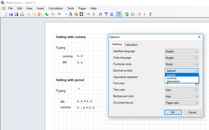

- while setting dot for comma, after typing comma a multiplication appears. Would be nice if, after typing comma here, the dot comma appears. In the opposite way it works.

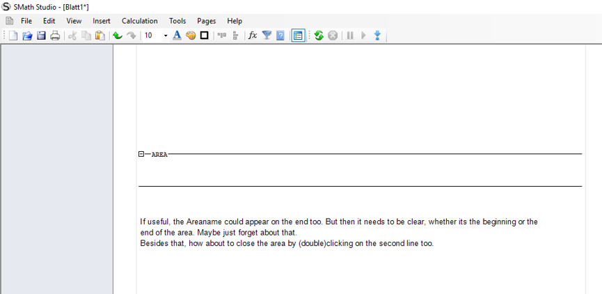

- the area name should also appear at the end of the area shouldnt it? And if I could close an area at the end of it too, that would be great.

What is an area ?
In Smath, you insert an area to collapse math/text/image ... regions.

coma [,] or [;] for arguments separators.
I should explain that with a picture.

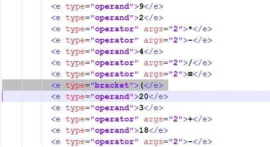

Hi. Or can hack the sm file deleting where "(" appears:
HackingEqual.sm (3.3 KiB) downloaded 1491 time(s).

Hi G-Tate. Difficult. I edit the sm file with a text editor and delete the "bracket" lines:
Thanks very much!
Thats a nice trick to know.
But of course not the real solution.

You see, it was just a request and I could spare some time being able to have an operator with the possibility to have multiple "=" to set some defintions.
With the trick from Razonar I will be fine for now, if searching and deleting the bracket lines doesnt gets to costly.
