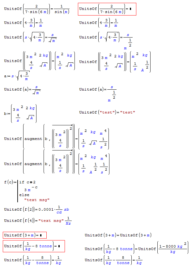

Strange behavior, I have to investigate it...
BTW in the Extensions Manager, section Snippets, there is a Snippet called "Operations with units"; if you download it, you can insert the snippet in the canvas typing "Units" and then pressing the TAB key. In this snippet there is a version of UoM made with built-in functions (only for scalars).
Ok ok, I was lost in a glass of water...
UoM was designed to act in a generic way both with symbolic and numeric data... when you use it in a inline function, since x is unknown, his unit is 1 (dimensionless - hold the mouse over the definition); if you want to use it in a inline function you have to use Units(x):UoM(eval(x)). In programming functions (when you use line), eval in the argument is not needed, because the evaluation of UoM(x) is made when you call your function.
![2016-03-11 00_18_01-SMath Studio Desktop - [Page1_].png](/zh-Hans-CN/files/Download/XXxbrA/2016-03-11-00_18_01-SMath-Studio-Desktop---[Page1_].png)
Obviously if you know the dimensions the best approach is the one suggested in the post above (#9) by Jean.

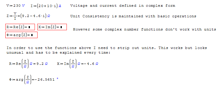

The background behind my query is that I use complex number calculations a lot for electrical engineering. Smath handles units well for basic complex number calculations but certain key functions do not work with units (Arg(), Re() and Im()) in particular). You can get around this by dividing off the unit but this looks inelegant and needs to be explained every time I show the work to someone. I hope to write my own user defined functions to replace them and having a UoM() function is a nessecary step.
WroteThe background behind my query is that I use complex number calculations a lot for electrical engineering. Smath handles units well for basic complex number calculations but certain key functions do not work with units (Arg(), Re() and Im()) in particular). You can get around this by dividing off the unit but this looks inelegant and needs to be explained every time I show the work to someone. I hope to write my own user defined functions to replace them and having a UoM() function is a nessecary step.
I use lot of complex too. Im(,) Re(,) work well in Smath 5346.
A short example would help to compare.
Jean here is an example showing what I mean. The functions Re(), Im() and arg() don't work when the operands have units.
