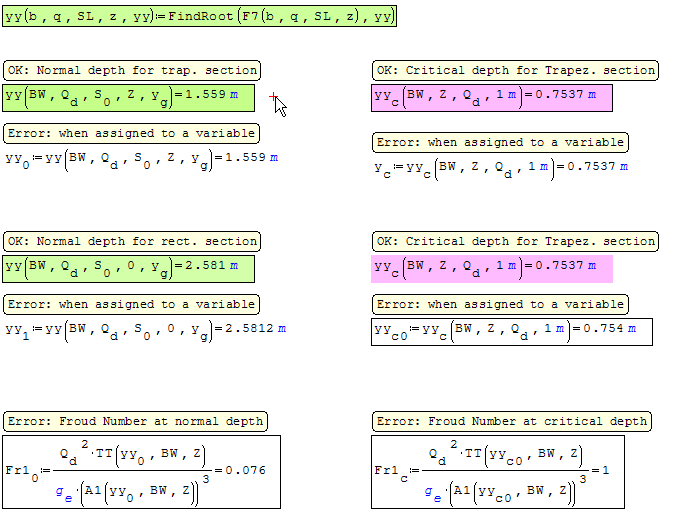

Hi
The "Open Channel Design" file attached earlier had erros inside the program section in calculating the critical slopes for each bed width. The corrected program is attached now.
Regret any inconvenience.
Now I observe that the result of FindRoot function unable to assign to a variable in attached SS file.
Test_FindRoot-1.sm (40.22 KiB)已下载 1373 次。
Above file was extracted from the original file Channel Design-using FindRoot-R1.sm (206.01 KiB)已下载 1388 次。 for testing, but both had the same problem
under SS 0.98.5981. However, it was perfectly OK when I uploaded on 18th Oct. 2015 (cannot remember the SS version).
As Andrey has suggested, I did a clean installtion of SS, but the problem still exists.
Another isuue is also shown in the image.

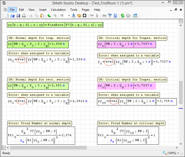

A working fix is to use line() in the function definition. Hope this helps Andrey to find a permanent fix.
Test_FindRoot-1.sm (40.68 KiB)已下载 1372 次。

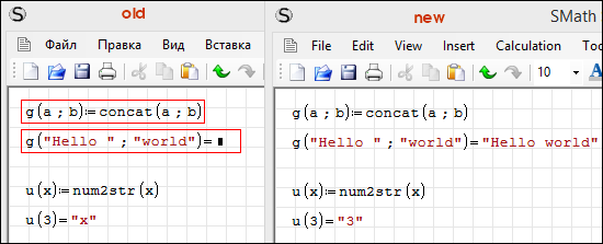

So, new build is here: http://en.smath.info/forum/yaf_postsm34488_SMath-Studio-0-98-5990--26-May-2016.aspx#post34488
It has corrections related to this topic.
I suggest to update plug-ins according to this comment: http://en.smath.info/forum/yaf_postsm33336_SMath-Studio-0-98-5973--09-May-2016.aspx#post33336
I you have to use not updated plug-in please give a chance to eval() function:
Why these changes are done:
Regards.
Davide Carpi 2016/5/26 20:05:00

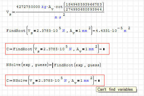

This still does not work:
BugFR.sm (6.15 KiB)已下载 1441 次。
I am a little needy here, because without a working FindRoot() function I am left without a solver that I can use to assign values to variables. I do this all the time in tasks similar to... How many stirrups do I need in this RC beam?
Hope you guys can get me the FIndRoot() back :-)
... A peculiar occurrence. If you place the cursor inside the first red box and hit Ctrl + >, the 2nd red box will evaluate correctly. Magic!!???

It works as it should. You assign A.v in the first solution, thus in the second (C:...) there's nothing to solve. Use Clear(A.v) after the first to make it working the 2nd.

Thank you, I was not aware that FindRoot() automatically asssigns the result to a variable. I guess I was just stirring mud here..
Actually if this is correct this feature might be undesirable. What if you wooul like to solve a list of equations that have same variable? You will have to use "clear" every time...
Thank you Andrey!!!
