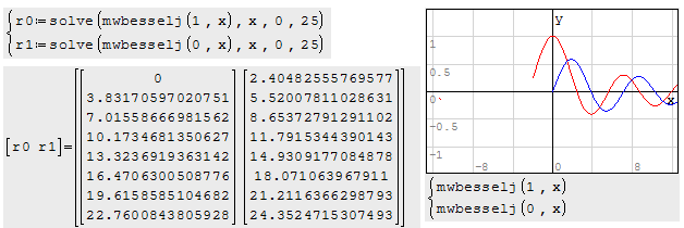

Often, in advanced works, we have to check [sanity check]
results. Casio [Keisan] on line calculator(sss..] is Bible.
As the matter example was Bessel: here is the document.
Link to Bessel-Keisan in turquoise.
Cheers ... Jean.
Bessel JY.sm (85.01 KiB)已下载 1202 次。
