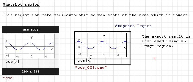

If you can resize by mouse action all over the region, why do you need the placeholders? Resizing just by dragging any point inside would be easier than to point at the tiny markers...
BTW, if the image is displayed using an image region (by uni), then the image export is silently blocked for the rest of the session, even if the image region is removed afterwards. This might as well happen if other software has the images open. Thus I would recommend to issue an error message if export fails (if that can be checked).
WroteBtw export reports are available in the bottom left corner of smath

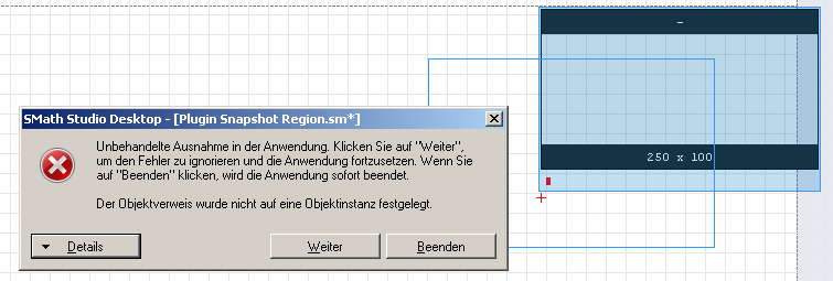

BTW: The region is not Ctrl-drag-proof.
WroteBTW: The region is not Ctrl-drag-proof.
What's the issue with ctrl+drag?
http://screencast-o-matic.com/watch/cIQTrhVm8V
mhhh... Isn't the same behavior of other regions?Wrotedone see the post above
Found & Fixed, thank youWroteSorry for being unspecific, see attachment. To relieve you have to press continue and then ESC to drop the copy operation.

WroteHandbook page for Snapshot region added.

WroteI'd propose to write the export files with white background instead of translucent. Perhaps this might be an option. The problem shown in the attached image could also be solved by the image region providing white background. But that would not be entirely equivalent, because the Image region is currently unaware of the image dimensions.
That's an image region feature, the exported PNGs are not transparents (try yourself opening the images with an image editor)
