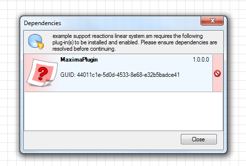

#7 已发布: 2013/9/18 16:19:08
325个赞和1个踩,共2,052个帖子。
Davide, look at the first picture please - there is only one placeholder at the right side for resizing. I con not find the placeholder on tho bottom or at the right corner.
Martin, look at the second picture please. Where is this comming from . I just opened the file you attached to the previous post and this message box appeared. Is there any Maxima plugin in the development and not available at the moment?
#8 已发布: 2013/9/18 17:16:15
1,362个赞,共2,276个帖子。
Sorry for the confusion. LinSolve(2) is from Maxima, I forgot to switch that back to the snippet version LinSolve(1). Just remove the second argument, then the file should run.
The plugin is going to go public soon. One of our students is doing a great job with the coding work, I am doing the specification/docs and the testing. We just want to have the user interface (functions) to settle a bit. You find some doc preview in the SVN activebook. You can use the waiting time to install Maxima (plugin developed and tested under win only).
