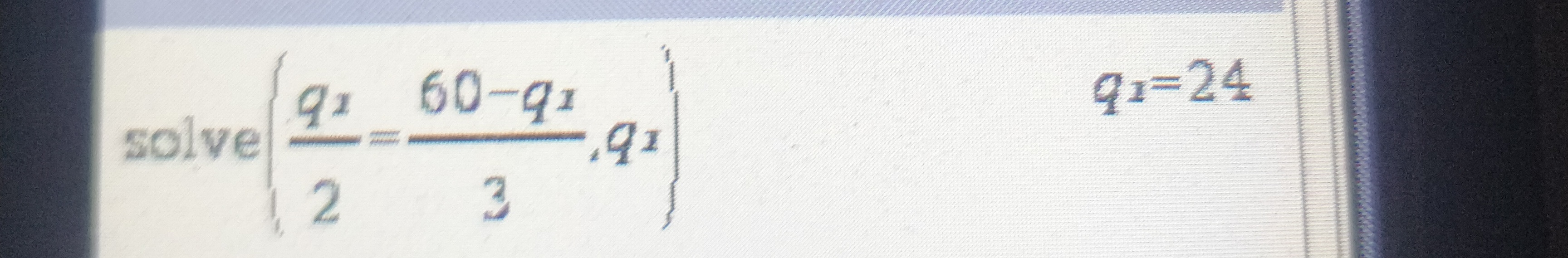

Is there any way to solve proportion's like in TI-nspire cx? (look at picture)

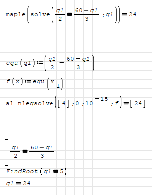

29 likes in 79 posts.
with Maple
or with Maxima

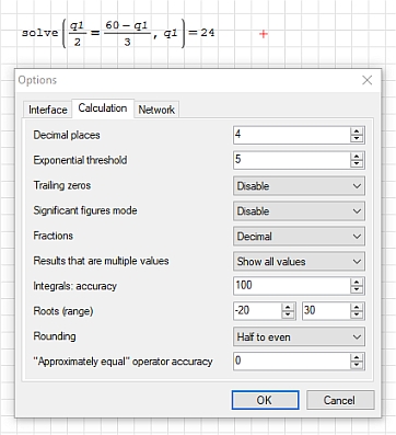

#4 Posted: 2022/10/16 20:52:58
1,106 likes in 1,784 posts.
Hi. In addition to the churichurro solution you can also use SMath native solver after changing the roots range.

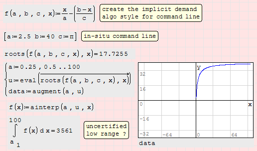

#6 Posted: 2022/10/17 07:41:28

#8 Posted: 2022/10/17 10:13:40
597 likes in 1,377 posts.
In addition to Razonar's reply;
You can also determine solve() range within the function itself.
You can also use roots() and FindRoot().
#9 Posted: 2022/10/17 19:49:42
... get more, no sweat.
#10 Posted: 2022/10/17 21:28:37
There are also plugin solvers.
Maxima can be added to collection as well.
