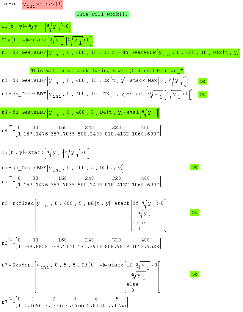

I played around a bit with the examples by Radovan.
My observations:
- using stack() or not is irrelevant in the single first order equation case.
- D and initial condition may be scalar or vector-valued.
- if() and Max() and eval() work, if D is defined inline (in the solver argument list), they do not work, if D is defined outside.
- the different behaviour of Rkadapt is due to poor convergence of the adaptivity algorithm.
- if rkfixed (and possibly the other solvers as well) fails, then you can evaluate the expression using = and get an error
- if rkfixed succeeds, there is no way to evaluate it using = (key is ignored), you have to use assignment instead
if-max-eval.sm (12.95 KiB)已下载 1791 次。
#42 已发布: 2013/8/5 14:37:42
1,558个赞,共1,868个帖子。
Updated. Source code refactoring.
The problem here is not the solvers, the problem is in the values ​​of the function parameters.

#43 已发布: 2013/8/5 14:57:23
1,558个赞,共1,868个帖子。
My observations:
Do not recommend using scalars. The point is that the ode functions in SMath Studio are described as follows:
引用
new ArgumentInfo[] {
new ArgumentInfo( ArgumentSections.ColumnVector ),
new ArgumentInfo( ArgumentSections.RealNumber ),
new ArgumentInfo( ArgumentSections.Function )
For now there is no strict monitoring parameter types, but it can occur in the future. I can make support for scalar parameters, but then for every function I need to write it analog with different set of types of parameters.

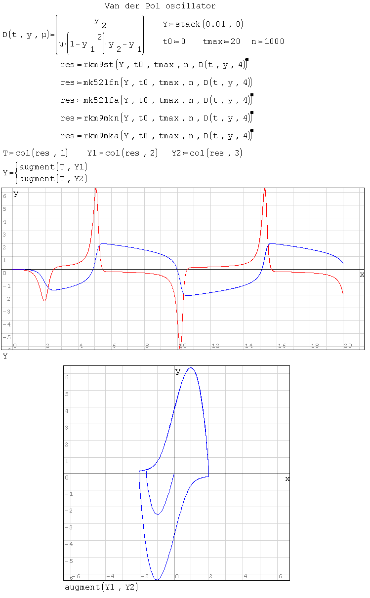

#49 已发布: 2013/8/13 22:51:32
1,558个赞,共1,868个帖子。
Updated. Added functions from the Intel® Ordinary Differential Equations Solver Library: rkm9st(), mk52lfn(), mk52lfa(), rkm9mkn(), rkm9mka().
mk52lfa() not finished yet.
ODESolvers. Van der Pol oscillator.sm (10 KiB)已下载 1844 次。
2位用户喜欢此帖子
Davide Carpi 2013/8/14 04:20:00, Radovan Omorjan 2013/8/14 03:30:00

#52 已发布: 2013/8/14 05:37:41
1,443个赞,共2,936个帖子。
Works on x64 systems (at least on my notebook), except for the mk52lfa(Y,t0,tmax,n,D(t,y,4)) (Y not defined)
best regards,
Davide
#53 已发布: 2013/8/14 05:46:46
1,558个赞,共1,868个帖子。
best regards,
Davide
Thank you, Davide. Unfortunately, this function requires the Jacobian. It must be specified explicitly. Some other functions also require it, but it can be omitted. I'll have to change the number of parameters to a function call.

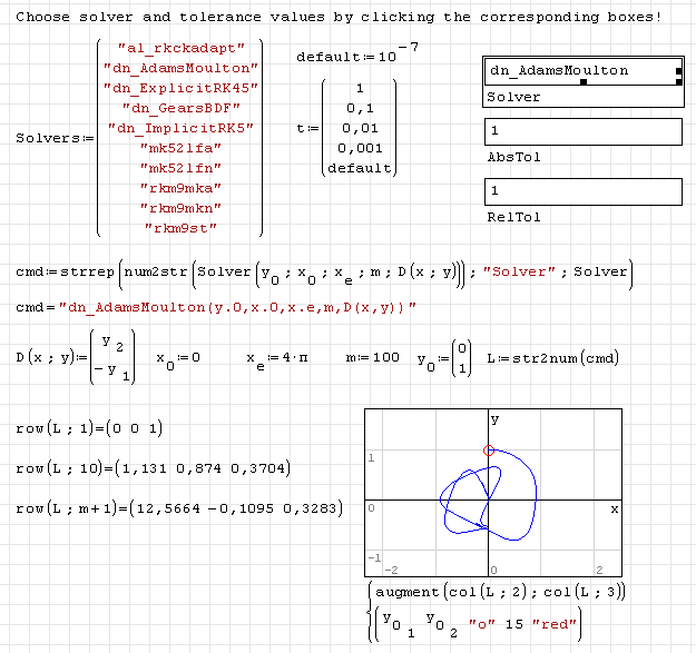

#55 已发布: 2013/8/14 10:42:48
1,362个赞,共2,276个帖子。
Here is a nice little toy for exploring precision control. Have fun!
2位用户喜欢此帖子
Radovan Omorjan 2013/8/15 01:29:00, Вячеслав Мезенцев 2013/8/14 17:15:00

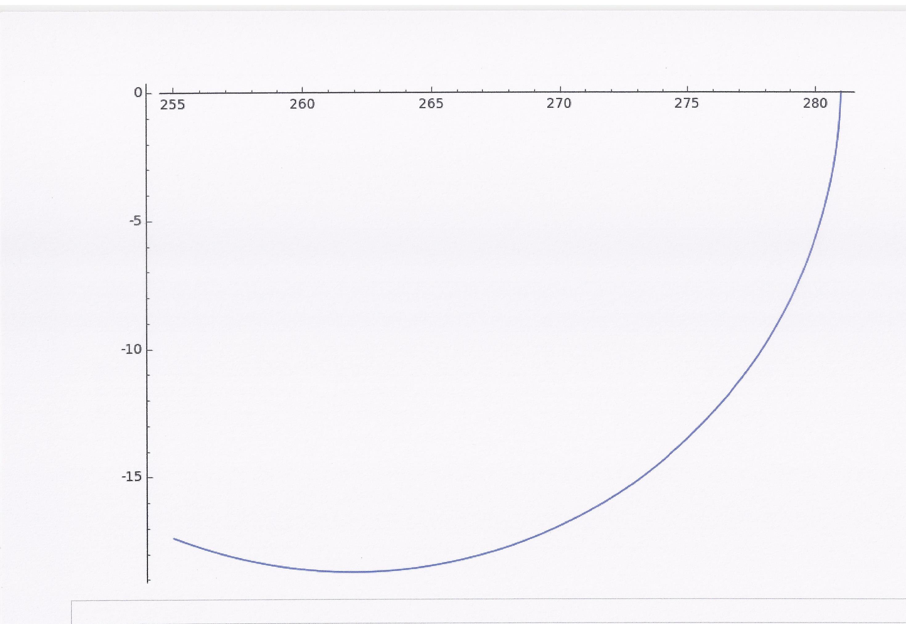

#59 已发布: 2015/5/15 05:36:35
madan26
madan26
0个赞,共2个帖子。
I have solved one equation in sage math but not able understand how to solve in smath anybody can guide me on this. below is my equation
exercise1
r = var('r')
PI = pi.n()
rc = 281
rw = 262
Bc = 36/180*PI
F = (r^2-rw^2)*sqrt(rc^2-r^2*sin(Bc)^2)/sqrt((rc^2-rw^2)^2*rc^2*cos(Bc)^2-(r^2-rw^2)^2*(rc^2-r^2*sin(Bc)^2))
F.show()
z = function('z',r)
d = desolve_rk4(diff(z,r)-F,z,ics=[rc,0],end_points=255,step=-0.01)
list_plot(d,plotjoined=True, aspect_ratio=1)
#60 已发布: 2015/10/8 00:11:23
