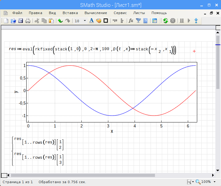

Updated. Skip intel ode assembly loading if Linux used. So in Linux only 2 functions available: rkfixed() and Rkadapt().
Raspbian on RaspberryPi 3.

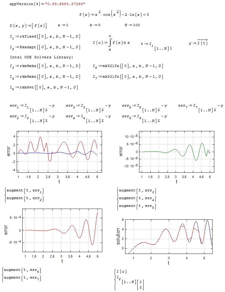

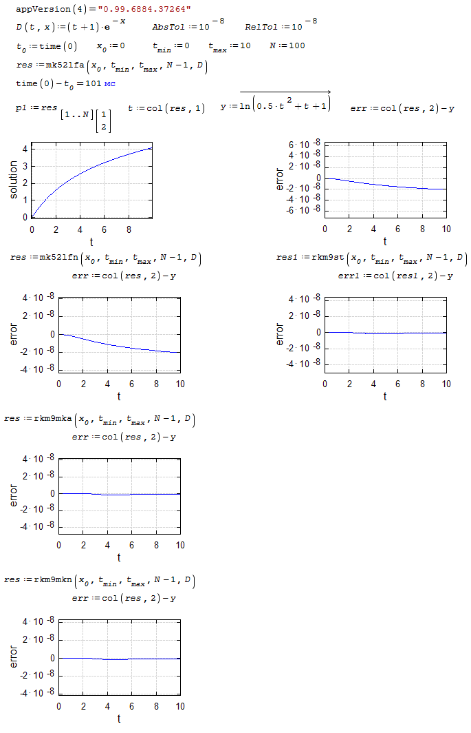

Simple intel ode test 2.
iode.test2.sm (22.5 KiB)已下载 2287 次。
iode.test2.pdf (121.64 KiB)已下载 1147 次。
sergio 2018/8/1 18:06:00

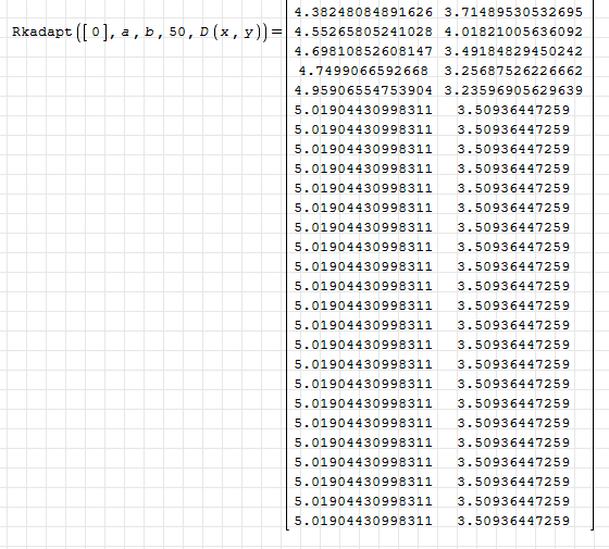

Updated. Fixed issue with zero point.
ODE test 3. Something wrong with Rkadapt().
iode.test3.sm (24.09 KiB)已下载 1773 次。
iode.test3.pdf (112.7 KiB)已下载 968 次。
Alvaro 2018/12/3 22:25:00
#73 已发布: 2018/12/3 23:32:02
1,139个赞,共1,805个帖子。
Hi Viacheslav. It seems that for Rkadapt t repeats itself, at least for low N values. Maybe you can handle that with some if abs(t[n+1]-t[n])<(some tol) then do something for modify t, and not add it to the final solution. Probably it could be because your step size goes too short.

#76 已发布: 2018/12/4 09:55:44
983个赞,共6,866个帖子。
It looks OK to me from Rkadapt design.
It reaches solution in 42 steps vs fixed 100.
iode.test3 Strip Rkadapt.sm (11.15 KiB)已下载 1768 次。
#77 已发布: 2018/12/4 10:17:01
983个赞,共6,866个帖子。
... In fact: Rkadapt reaches solution in 35 steps.
MCD Rkadapt results in equally spaced solutions.
MCD rkadapt comes with two extra parameters
"acc" accuracy
"s" step size
As it looks Smath Rkadapt muffs the start,
Try 34/35 => observe the result.
iode.test3 Strip Rkadapt.sm (16.85 KiB)已下载 1809 次。
