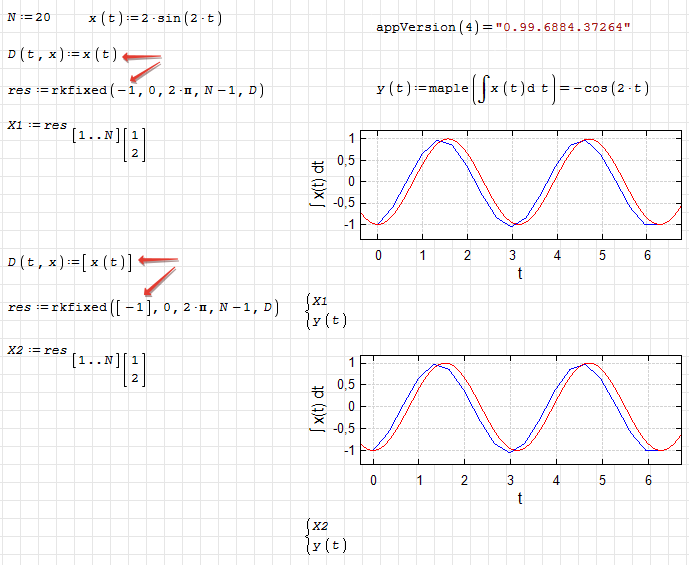

But x in D(t,x) is vector.

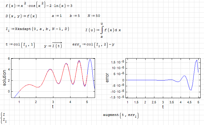

#83 已发布: 2018/12/24 05:33:39
1,558个赞,共1,868个帖子。
Updated.
Now x in simple D(t,x) definition must be a scalar.

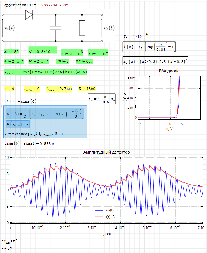

2018-12-24_13-43-45.png iode.test1.png iode.test2.png 2018-12-24_13-32-46.png

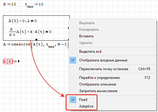

No, Jean, 1/1 - not possible. Now they have two different realisations: MC11-MC15 and Prime. But I can do something similar. Plugin can implicity collect information about available ode solvers and you can choose them in the context menu.

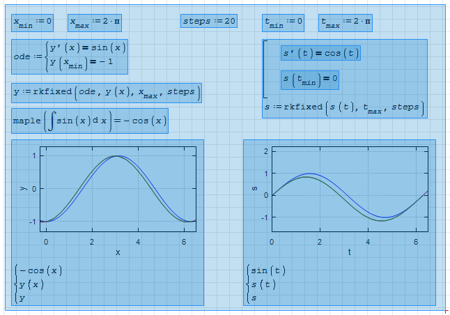

#93 已发布: 2021/11/26 00:11:56
1,558个赞,共1,868个帖子。
Coming soon, but for now as an experiment.

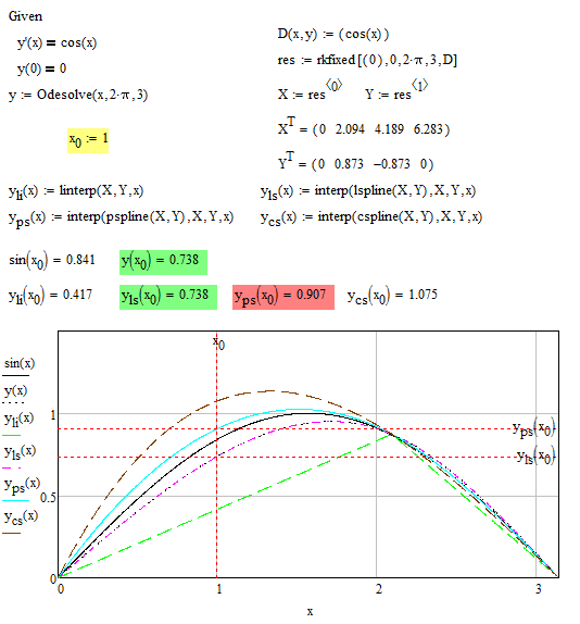

#97 已发布: 2021/11/29 02:43:07
1,558个赞,共1,868个帖子。

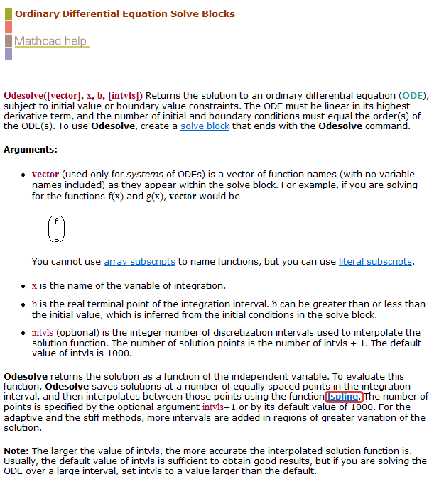

A simple test that shows the interpolation method used by the ODE solver. Obviously, the lspline() function is used.
Odesolve() with rkfixed method (Mathcad 15).
Odesolve interpolation test.mcd.zip (8.84 KiB)已下载 517 次。

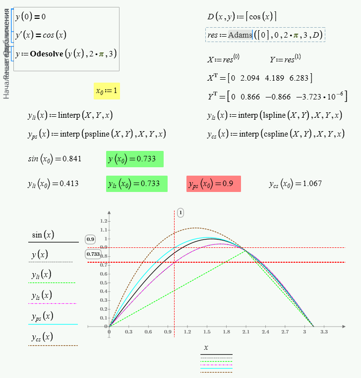

The same for Mathcad Prime 7.0 (Adams method used).
Davide Carpi 2021/11/29 06:40:00
#98 已发布: 2021/11/29 20:31:00
1,558个赞,共1,868个帖子。

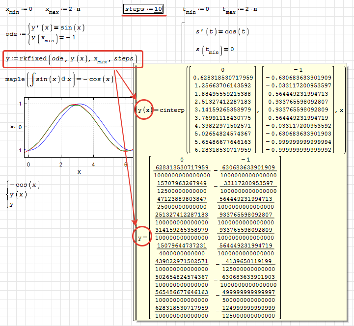

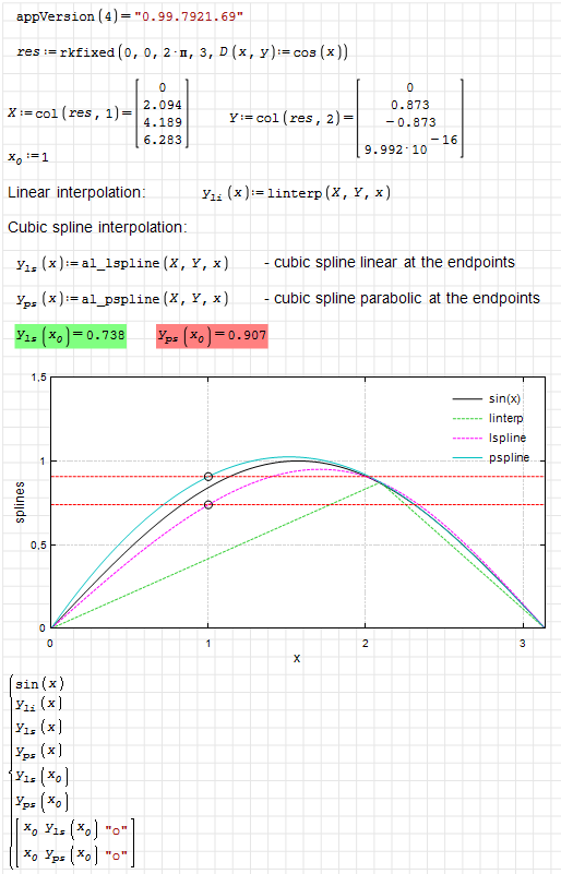

Ok, I found a bug in rkfixed() and finally figured out the difference between interpolation functions. In the picture below, I repeated part of the calculations from Mathcad. As you can see, to interpolate the numerical solution of the ODE, a cubic spline is used, linear at the end points.
Bugs will be fixed when the build server starts working.
Links:
1. Cubic spline
2. Cubic Spline Interpolation
Cubic spline interpolation using Mathcad (2009).pdf (256.71 KiB)已下载 2781 次。
