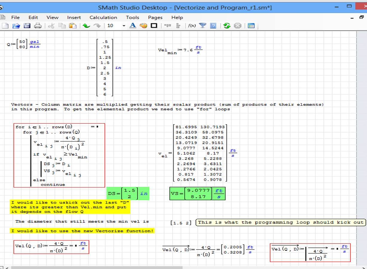

Jean will be proud (algorithm) and disappointed (would like to use vectorize)
I would like to know two things ... Vectorize and Program.sm (14.29 KiB)已下载 1398 次。
1) Can I convert my algorithm and use vectorize?
2) I want to pull the diameter that corresponds to greater than Vel.min

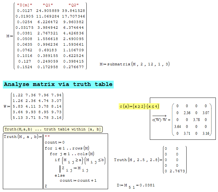

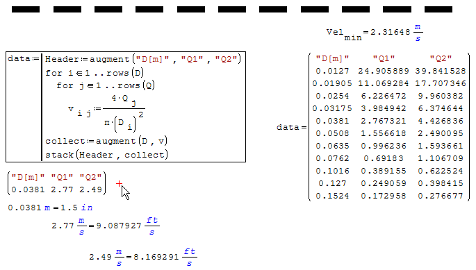

Thank you. Never used Augment before ...
Not for the piping designers, for me to double check other calculation. Everything is off of "packaged" software and I like to double check the maths. Curious if a second routing can be used to solve for the the D. If V.i,j>V.max keep solving, else, stop. Putting kids to bed and will look into that
Just remove erroneous declarations, and use DS in function invocations (your D variable is defined having 11 rows, Q has 2 rows, you should use DS having 2 rows).
Vectorize and Program.sm (14.58 KiB)已下载 1409 次。
P.S. My screenshot is just a follow-up of previous suggestions (Jean's and CBJ's).
My sheet is another approach without any loops, just vectorize() end eval().

CBG is more of what I envisioned. I don't understand the array variable. Will need to put in my sheet to fully understand. I was going about it in a different way, this i better.
Mike, your solution is when I know the pipe sizes. I am solving for the pipe sizes from a data table ... essentially, they don't want to solve, they want to use the Crane manual.
In that project, there are two erroneous concepts:
1. Non SI systems are too specific. Behind the scene, the General Chemical Engineer
does lot of conversion to accomodate the low level Imperial team work in some way.
2. I Chemical Engineering, they don't use volumetric flow rate: they use "mas flow rate"
... Jean , I want 10 t/hr of water @ 100°C ... all that will come into my orifice
plate calculations. I better take into account the water weight density @ 100°C.
The error would be immense on the top of an unknown [+/-] 0.6%] error from the orifice plate.
From what I can see, tabulating some sort of useful data will be the other way around .
The first column is the Q [massflow rate], from which you calucalte the speed versus
the diameter. So, there will be as many speed column as there will be diameters.
Doing so: the data table will be visual for checking. QA controllers, they don't care
gadget calculations, they go by the book. Also, consider what a CAS like Smath can do.
The truth table is not a gadget, it is almost the only tool to search in data table
that dont have integer values , though you can round off but can't surely round the speed
to integer values.

What's wrong with the counter? Getting "0" for first output, not 1.5.
Vectorize and Program a.sm (9.56 KiB)已下载 1366 次。
You have an error, the "Line " command should be in the second loop.
Annex corrected fileVectorize and Program a_r1.sm (9.57 KiB)已下载 1404 次。
