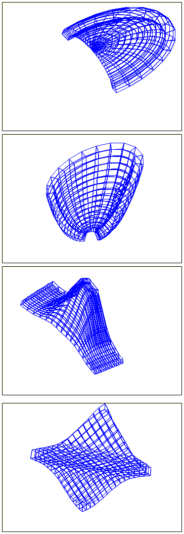

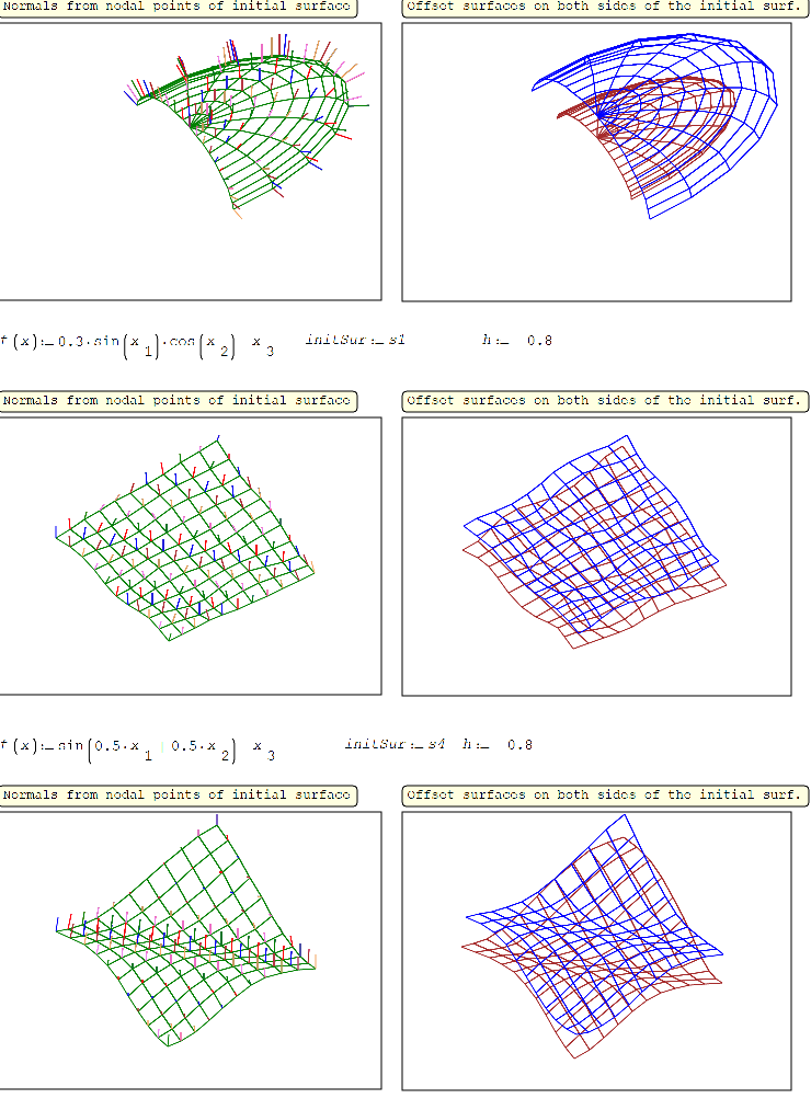

An initial surface is given, given by the "createmesh" function, which forms a
network with nodes.
Dyou want to create an offset surface, offset by an amount h from the initial.
The direction of displacement surface epends on the sign of h.
Sequence of calculation:
1.Restoring the normal from the nodal points of the initial surface and we get
the nodal points of the displaced surface.
2.We connect the resulting node points
The image is built on three-dimensional graphics and can be rotated with the mouse

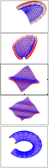

Converting Surfaces to Solids
The solid is formed from the initial surface, the offset surface, and the
lateral surface that connects them. The lateral surface is formed by normals
reconstructed from the boundary nodal points of the initial surface.

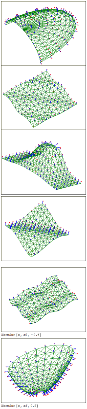

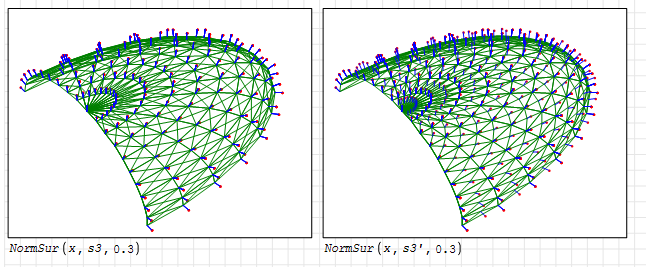

Normal to the surface on Rezonar's triangular mesh
NorSurAlvaro.sm (49.33 KiB) downloaded 1247 time(s).
NorSurAlvaro.pdf (623.77 KiB) downloaded 682 time(s).

Hi. The same but with a different version for the triangular mesh.
NorSurAlvaro v2.sm (77 KiB) downloaded 1177 time(s).

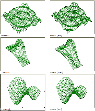

Examples of meshes with vertices
Nodes.sm (49.04 KiB) downloaded 1220 time(s).

Creating surface thickness with triangular meshes
