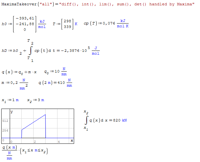

Maxima can handle integrals with units. Yet the restriction applies that the integration variable must be undefined.
int_issue_Kr_units.sm (10.14 KiB)已下载 1212 次。

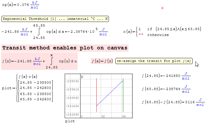

Native Smath does it in much greater elegance.
int_issue [Transit Method].sm (9.39 KiB)已下载 987 次。

Refreshed version managed from annoying units
Integral 0000000 Transit-Units.sm (23.78 KiB)已下载 1220 次。
