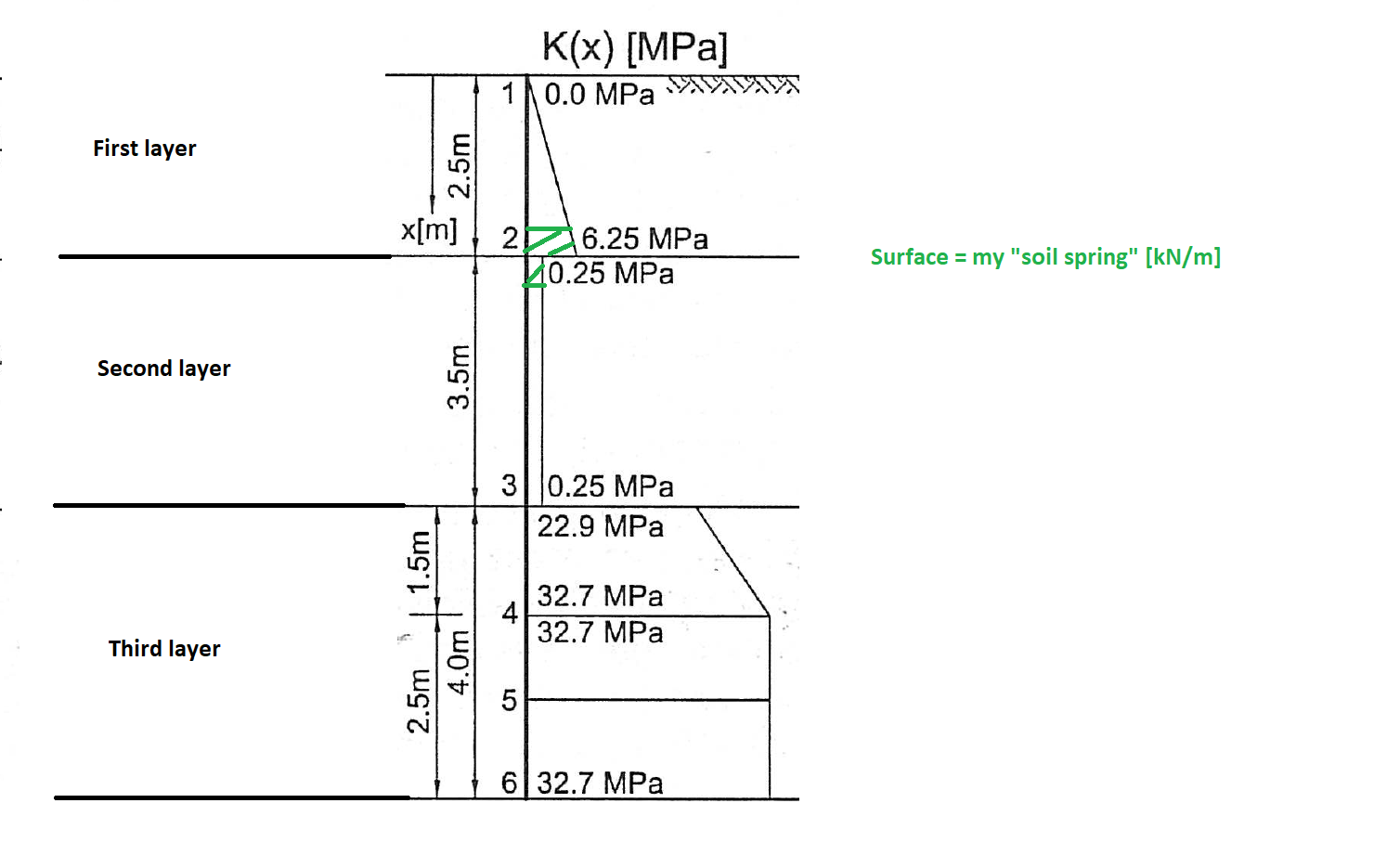

I'm trying to write a function that I can use to calculate the surface area. The function is to be based on data from a matrix with n elements
I ran out of ideas. I guess the problem is in a loop.

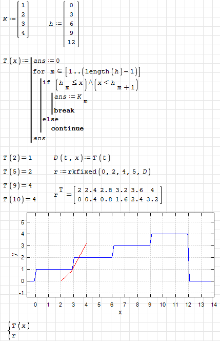

You can try something like this

I will try to explain what I need.
Depending on the soil layers, I have a graph similar to the picture. At a later stage, I want to divide this chart into equal pieces (for example 0.25 m or 0.5m) to obtain "soil springs".
To simplify the example, I assumed that the elements of the K matrix are constant.

OK ... from there, apply your skill to produce the Cartesian graph
of the piecewise soil. No problem to integrate.
True Viacheslav: ODE integrator(s) are very excellent.

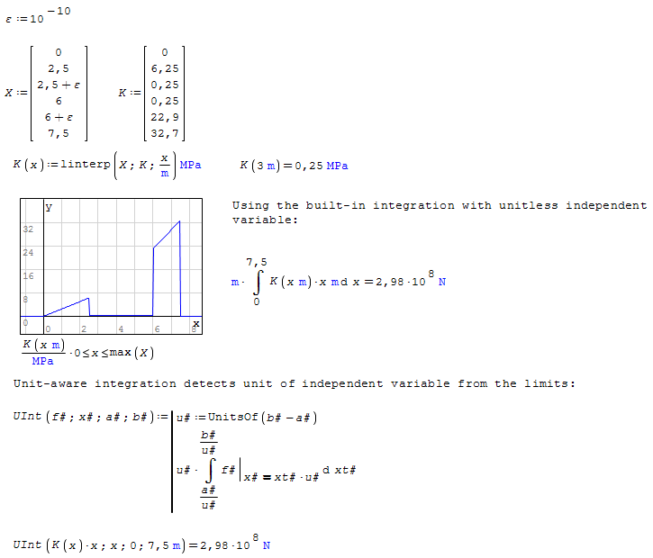

Thank you very much,
(btw the "thank" button on this page does not work)
The idea of ​​using linterp is actually much better instead of a loop.
Below is the file with the result I needed.
Final springs.sm (20.64 KiB) downloaded 887 time(s).
#15 Posted: 2019/9/22 09:43:08
The idea of using linterp is actually much better instead of a loop.
The "Tanks" button used to work years ago, not any more.
Good work ... two comments:
1. subscript is confusing with sub-sub index.
Very many projects are sub-sub indexed.
Reserve subscript as tutorial [exemplified].
2. variable name confusing with number is another killer.
you had 1:=max(X).
SS7030 was reputed good version, compatible SS 6179.
Final springs_1.sm (24.73 KiB) downloaded 893 time(s).
