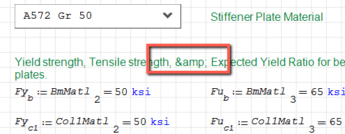

#8 Posted: 2021/1/19 19:58:27
Jason McCool
Jason McCool
9 likes in 78 posts.
It also seems to be replacing symbols with codes like below, where it replaced "&" with "&".
Thanks!
Jason
Andrey Ivashov 2021/1/19 20:29:00
#9 Posted: 2021/1/19 20:30:12
2,326 likes in 4,013 posts.
Jason, thank you very much! Will fix it asap.
