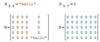

I writing work on High School on topic IIR filtres and I need to create matrix of order 0.
In matlab:
p_0_NDP = []
p_0 = Omega_n * p_0_NDP;
In SMath studio?
x:#clean# - does not work
Thank you for help.

ZeroMatrix: like this

But it is not. If I insert M(0) is length matrix 1, but I need length matrix 0

I don't believe SMath supports empty Matrices.

A matrix of order zero is a "zero matrix"
If you want it rectangular from the fx menu
'Ones(3,5)' ,,,, then of any value: *1.23456789=

Example for declaration and use of an empty matrix:
stack.sm (11.99 KiB)已下载 1555 次。

Awesome. Thanks, Martin. I did not know that empty matrices were supported.
