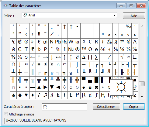

Hi IAks,
You don't need a plugin, just the right Unicode character (you can copy and paste the character from one site like Wikipedia, tamasoft.co.jp, alanwood.net or you can add the character holding the U and typing a #CODE# from the numpad)
look the attachments
regards,
w3b5urf3r

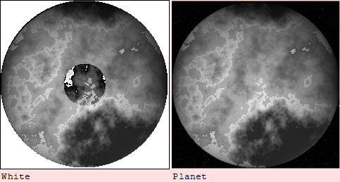

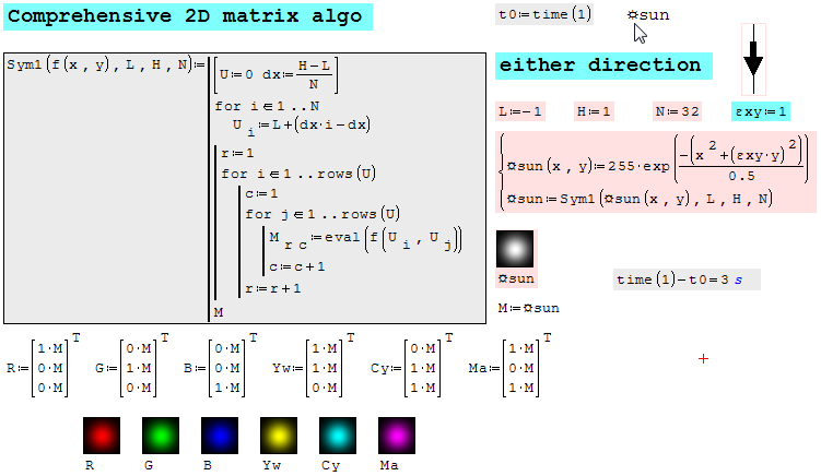

WroteIn astronomy I need to use a symbol that looks like a circle with a dot in the middle as a subscript
... from 6 years old .
Tentatively we can highlight a specific circular region.
The attached were left unfinished.
Image Planet Luminosity_1.sm (100.57 KiB) downloaded 946 time(s).
Image Planet c(planet)planet.sm (79.22 KiB) downloaded 958 time(s).
Image Planet fmap.sm (183.45 KiB) downloaded 984 time(s).
Image Planet Luminosity.sm (219.14 KiB) downloaded 924 time(s).
Image Planet Luminosity_2.sm (236.04 KiB) downloaded 932 time(s).
Image Planet Gamma.sm (315.73 KiB) downloaded 1002 time(s).
