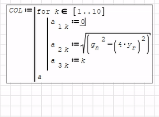

hi can anybody please explain why the following does not work, and how I need to change it.............
many thanks

No problem here. You have misspelled the function.
The equality for 3*4 or 4*k is next to matrix element.
It has to be next to matrix, whole of it.
COL_FOR.sm (4.49 KiB)已下载 1280 次。

Thank you "overlord"..............what a basic error, I feel stupid, must need new spectacles. hehe.

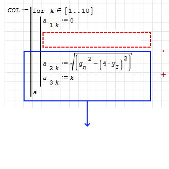

Folks, I have another query please and am grateful for help.
As per diagram below, how do I move several lines down and create space for another equation inside my "for" loop.
Use your arguments separator for this.
This works also for vectors but not for matrices.

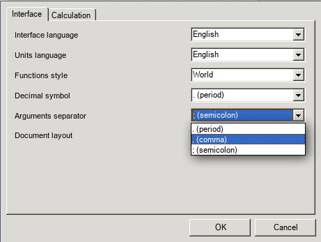

thank you, but can you please clarify what exactly is the "arguments separator" ?
#10 已发布: 2021/5/25 21:12:44
600个赞,共1,381个帖子。
It depends on your setting.
Its setting is under Tools > Options.
I use semicolon, default is comma I guess.

983个赞,共6,866个帖子。
how do I move several lines/cols down/right and create space

983个赞,共6,866个帖子。
Page12 Ravel Matrix.sm (9.46 KiB)已下载 1408 次。

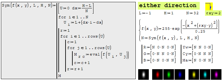

#13 已发布: 2021/5/26 17:59:38
26个赞,共155个帖子。
This is like Schrodinger's answer, both right and wrong at the same time, lol.
#14 已发布: 2021/5/26 20:07:15
983个赞,共6,866个帖子。
I greatly admire that you have recognized
the long functional romance was Shrodinger lol !
Otherwise coded from Mathcad ODEsolve .
Maths Schrodinger.sm (67.54 KiB)已下载 1204 次。
