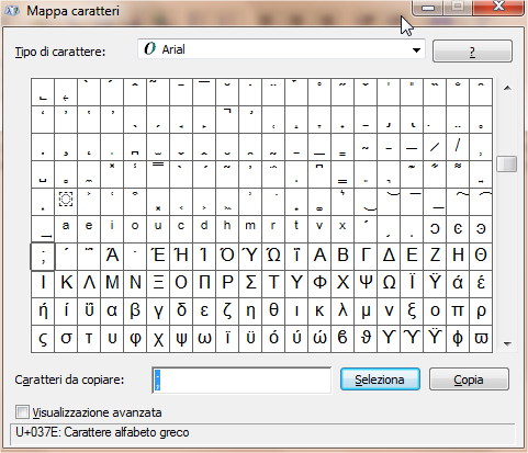

Thank you Martin,
The issue is related with a previously reported SMath bug: str2num problems with regional settings (2nd post); Waiting for the official fix, I've reuploaded the file with an hidden hack (I've used the greek semicolon ; instead of the latin semicolon ; ).
About the GPC plugin I think will be useful an english translation for this side of the forum (all examples and screenshots are in russian)
best regards,
w3b5urf3r
best regards,
w3b5urf3r

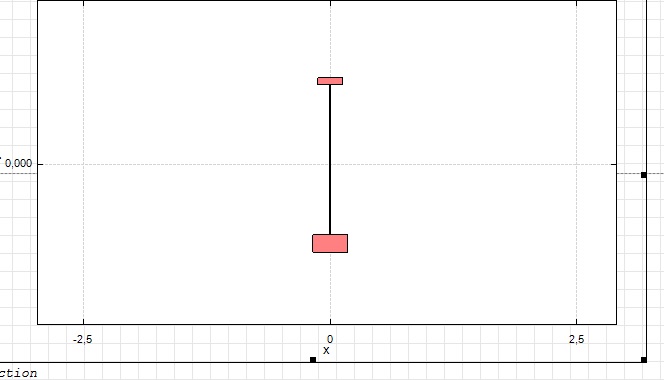

Firstly, let me thank you for such a wonderful work. It is amazing sheet.
To the point, Is it possible to arrange the calculation for horizontally asymmetric I profile? Such as following
Thank you!
Thank you!
Wroteof course it is possible
Ibeam_ha.sm (23.43 KiB)已下载 1581 次。

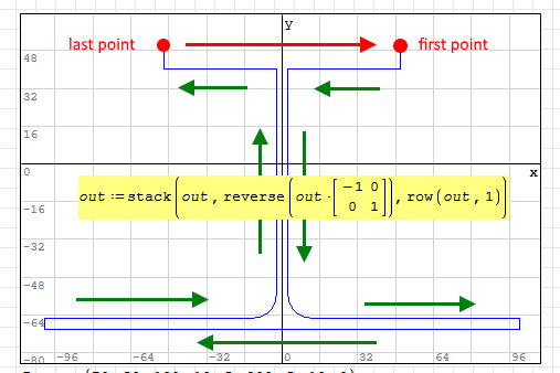

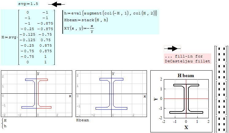

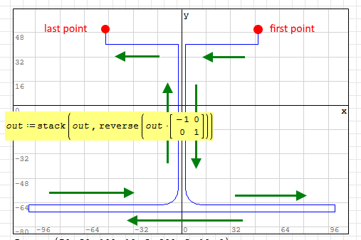

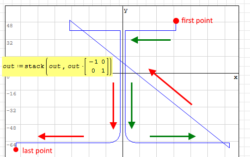

Sure!
First of all what we want to archieve is to draw the shape using less points and operations as possible.
(I've cleared the eval() that aren't needed)
About the fillet...
That's all, I think
- Taking advantage of the symmetry we draw one side
- Once we have the points, the other side can be drawn by symmetry using the symmetry matrix multiplication, then stacking the points; the problem is that they aren't sorted in the correct order
- This can be solved by using the reverse() function
- To close the figure then what you need is only to add as last point the first

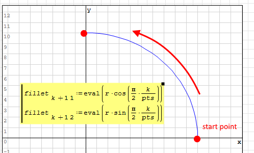

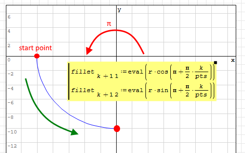

About the fillet...
- You can draw a counterclockwise arc in this way:
k/pts*pi/2 is the angle at each loop, and increments from 0 to pi/2 as k increments from 0 to pts - You can add pi to the angles above to have the arc with the correct order of points and the right orientation (remember that we are drawing the RHS of the shape)
- You have only to shift it from the origin to the correct location
That's all, I think
