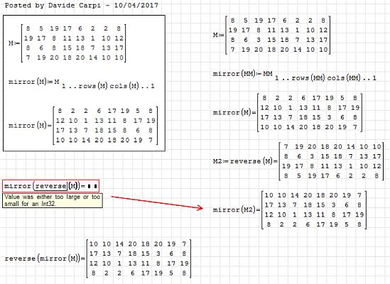

Why this happens with attached worksheet?
Mirror_Problem.sm (20.51 KiB)已下载 1425 次。
Davide Carpi 2017/4/11 06:22:00
#5 已发布: 2017/4/10 18:43:24
983个赞,共6,866个帖子。
The two red regions created "Unknown error".
The algorithmic chain fails.
Mirror_Problem.sm (20.51 KiB)已下载 1397 次。
Utilities Matrix Rotate Quadrant.sm (59.03 KiB)已下载 1417 次。
#6 已发布: 2017/4/11 06:22:38
1,443个赞,共2,936个帖子。
You found a bug in el(), thank you!
added in BTS [SS-2438]
#7 已发布: 2017/4/12 20:20:09
983个赞,共6,866个帖子。
Hello Davide,
IMHO, the case reported by collab NDTMA is not a bug.
Simply an instance of "shadow in the context" [Mathematica].
Similar broken algorithmic links have been encountered in Mathcad.
We can't play much with the "vector/matrix" codes.
Here is a similar example in the attached.
Cheers, Jean
