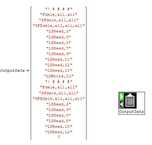

You can try using the plugin "Clipboard Region"
Once installed, go to "insert > Clipboard region" and add one to the canvas, then add the variable in the input placeholder and click on the top arrow to send the data to the clipboard

sergio 2021/3/17 12:28:00
