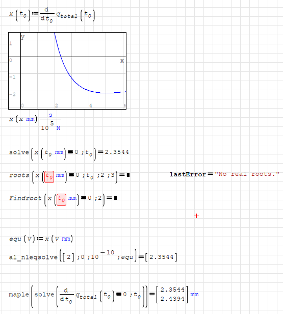

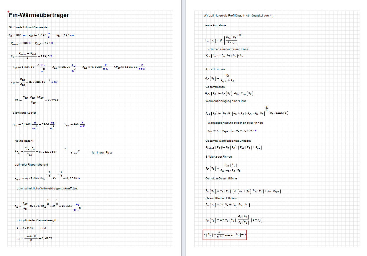

i need to solve the diff the funktion q.total(t.0) to find its maximum value. It alsways says t.0 not defined. What do I do wrong? Pls help.
Fin-Heatexchanger.sm (28.84 KiB)已下载 1516 次。

Fin-Heatexchanger_solved.sm (36.13 KiB)已下载 1494 次。

Thank you very much!
WroteI need to solve the diff the function q.total(t.0) to find its maximum value.
As given you have the range of minimum values.
For min/max of function ... Golden Ratio.
WroteThank you very much!
Sometimes general numeric solvers; solve(), roots(), FindRoot(); struggle with functions involving diff(), int(), sum(), profuct(), if(), cases(), etc.
In your case solve() could answer it. There are some situations which can't be answered by general numeric solvers.
Usually al_nleqsolve(), maple() or Maxima() can solve them.
