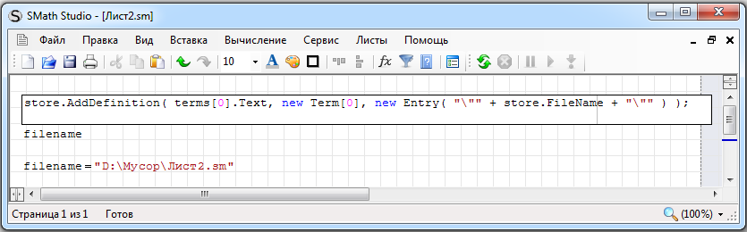

As workaround you can use simple C# script for this (Script plugin).
store.AddDefinition( terms[0].Text, new Term[0], new Entry( "\"" + store.FileName + "\"" ) );
A more complete code would look like Mathcad 11

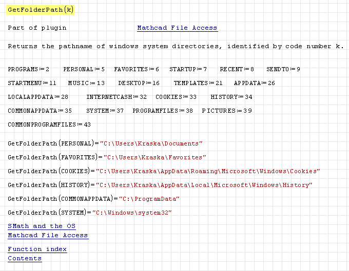

The function getfolderpath() seems to be broken for build 7219:
getfolder.sm (2.21 KiB)已下载 1790 次。
![2019-10-29 07_52_04-SMath Studio 0.99.7219 - [Blatt5_].png](/zh-Hans-CN/files/Download/spgdML/2019-10-29-07_52_04-SMath-Studio-0.99.7219---[Blatt5_].png)
