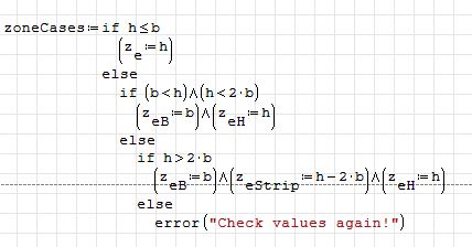

any way i can print a message in a for loop?
i have 3 cases that change 2 variables, but it would be useful to know in which case i'm in
thanks in advance
#6 Posted: 2013/3/14 10:08:17
1,441 likes in 2,932 posts.
Something like this?
regards,
w3b5urf3r
zoneCases.sm (8.59 KiB) downloaded 1211 time(s).

yes that did it,
thank you
