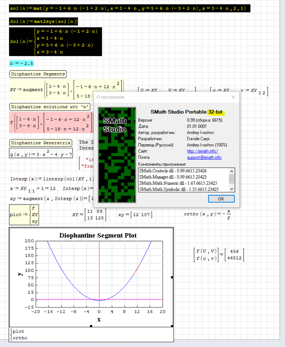

#1 Posted: 2018/2/9 13:01:57
Maybe your work sheet needs be doctored as well as mine.
It happens, correct during the session of construction,
but fails on re-opening PC [little pest].
Solve Diophantine X_Y Plot.sm (25.08 KiB) downloaded 1016 time(s).

#4 Posted: 2018/2/9 23:20:28
Hello Jean
Your file gives me the error of division by zero in the graph.
Hello Carlos,
In the collected plot, neither f, XY, xy can issue this error message.
Hope not, otherwise X_Y would be all bug.
The module ortho(x,y):= -x/y may be the guilty. Try to remove it.
Hope for more testing from the crew [Martin, Davide, Radovan ... for sure Andrey].
In fact, no Smath stable version is stable.
The latest, declared stable, will be after evaporating any traces of previous
installed version. Seemingly, no such procedure is defined by steps .
1. Uninstall Smath
2. Delete from the directory
3. Delete anything wrt Smath from the Registry ...
I found only two items belonging to Smath. How many more hidden
under no inspiring name ??? Watson, that is the question !
Cheers Carlos, Jean

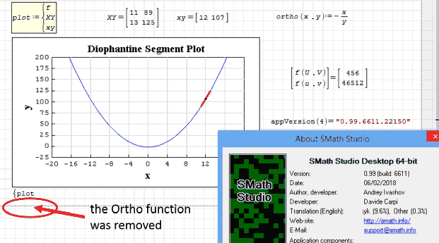

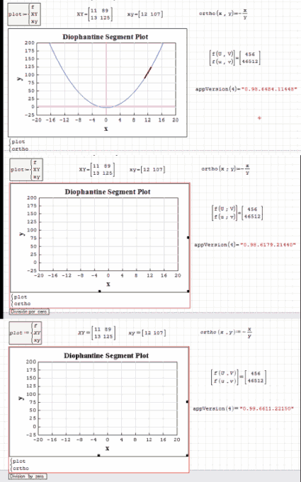

Hello Jean,
your file runs perfectly in the version of Smath Studio "0.98.6484.11448",
and fails in the versions "0.98.6179.21440" and "0.99.6611.22150", the error
is caused by the function "Ortho = -x / y". If this function is removed from
the graph, the error is eliminated, but only Parabola is plotted.
#6 Posted: 2018/2/10 01:21:17
Hello Jean,
That my friend is the most pertinent remark.
I have it the other way around: 6179 working great on XP Pro
6484 scrapped two work sheets, because I tried only two !!!
Whatever: there is a concurrent bug wrt X_Y wrt Smath versions.
Doctor one version, scrap the other one ... pest !
Cheers Carlos, Jean.
#7 Posted: 2018/2/10 07:23:12
2,326 likes in 4,013 posts.
Jean,
installed version.
I would disagree with you. Beta versions usually much more unstable. But yes, sometimes I make mistake and build 6606 should not be marked as Stable, because I've missed something very important. But this is exception. F.e. latest stable is really good.
I have checked your worksheet and see question we have here is not about stable/not stable, this is about environment. I have checked different versions of SMath Studio (including 0.98.6484.11448, 0.98.6179.21440, 0.99.6611.22150) - error is shown everywhere.
Then I've tried to open SMath Studio in 32-bit mode and this helped! When it is 32-bit worksheet calculated without errors and graph is shown correctly.
So this is about 32/64 bit and present in all versions of the program.
(build 6615 32 bit = build 6611 64 bit)

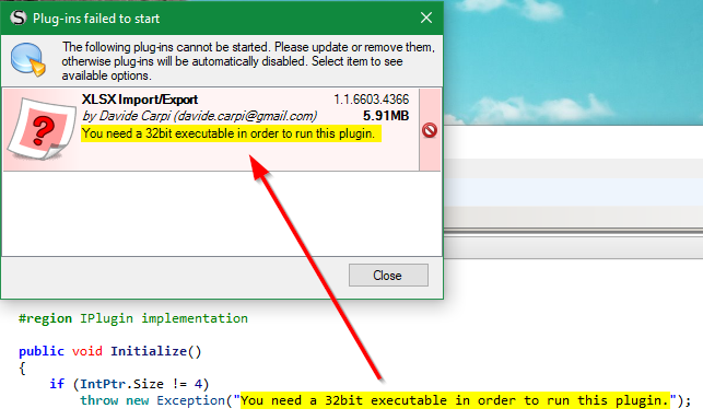

#9 Posted: 2018/2/10 12:12:35
1,441 likes in 2,932 posts.
The bitness is also known to be relevant for the function of 32bit mathcad user libraries in the Mathcad EFI plugin. These require SMath Studio running in 32 bit mode. I am not aware of plugins which insist on 64 bit mode, therefore my portable pre-configured distribution is generally set to 32 bit. It is in fact very easy to do using the CorFlags executable posted by uni somewhere in the forum.
I don't know how hard it is to switch or check the setting from inside SMath. My proposal would be to verify the matching bitness in the extension manager and at least warn about conflicts or just do the required adjustments.
However, I am not aware of a particular bitness of worksheets beyond the required bitness of the referenced plugins.
javascript:__doPostBack('forum$ctl03$PostReply','')
EDIT: From the info dialog it is obvious that the bit mode can be determined from inside SMath.
The bitness issue is typical of p/invoked libraries or external processes, something that smath can't manage automatically (except maybe introducing in the interface a flag that the plugin author can set manually to explicitly declare the plugin incompatible); however the developer can already throw an exception during the initialization to prompt the incompatibility to the user (mathcad efi f.e. has this check but it is suppressed in favor of his internal logger)
